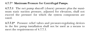

Well I'm not sure NFPA allows for these valves on centrifugal pumps.
The problem is that they don't want these valves to malfunction and drain fire water when you need it.
NFPA are fairly brutal with pumps and in my experience don't allow you to circulate water during a no flow test so the pump tends to heat up quite a bit....
see section 4.7.7
Basically don't mess with a Fire water system unless you really know what you're doing otherwise it will come back to bit you. Fire water packages are normally designed and purchased as a single item which is approved and you can't modify it.

Like I said NFPA are rather brutal on pumps. You could open up a hydrant somewhere which flows back to the pond, but NFPA 25 8.3.1.2 says " A no flow test shall be performed...
