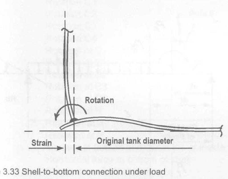

I am currently working on an AST project where the MDMT is -20 C- due to which we cant use our usual go to material, A-36, for shell and annular plates unless its impact tested (understandably so). Long story short, after discussing with our client, all shell plates above ~14mm are being designed for ASTM A 516 60 and those lower than that are being designed for A-36 Group 2 as per Figure 4.1a in API 650.
My question stems from a discussion I had with my colleagues regarding the stipulation in 4.2.10.1 and why annular plates/sketch plates fall under this category but the rest of the bottom plates do not. They argue that the whole bottom is still in contact with the fluid and will experience similar loads(they are lap welded to the annular plates, after all) so why should it be different from the annular plates? My contention was that the shell-bottom joint acts as a rigid joint and hence experiences greater dynamic stresses and moments that the shell experiences due to the attached piping.

When the liquid load is added in the shell, the shell expands more or less uniformly except at the bottom, where it is restrained by the bottom plate. So part of the hoop force that would normally be resisted by the shell is transferred into the bottom plate. I assume this is the motivation for requiring annular plates in larger/higher stressed tanks, and also the reason for requiring the notch toughness in this area.
