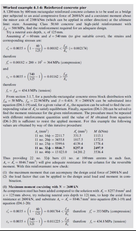

Quick background on my problem. I'm strengthening a doubly reinforced concrete column subject to combined axial and bending forces using FRP. I have calculated the phiPn and phi Mn necessary to create my P-M Interaction diagram. I need to check that the concrete stress at service load is less than 0.6f'c. I know what the service load is, and the ACI 440 FRP guideline provides a recommended equation for calculating fc. But to use this calculation, I need to determine epsilon,c, or the strain in the concrete at service loads.
Don't know if I'm over thinking this or what, but I can't seem to figure how I would go about doing this. I presume I somehow need to calculate the neutral axis location and then use similar triangles to get concrete strain from the reinforcing steel strain, but I can't for the life of me figure out how to do this or find any examples showing it. If someone could help me out I'd be very grateful. Thanks for any help you might be able to provide!
BrianStr,
Any decent concrete text book should show you how. Or your old university notes.
You have to iterate for extreme concrete compression strain and within that iteration, iterate for neutral axis depth until C = T. On each iteration calculate the moment of resistance and compare to your service moment. When they are equal you have your service strain.

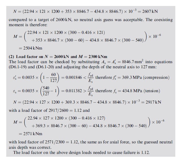

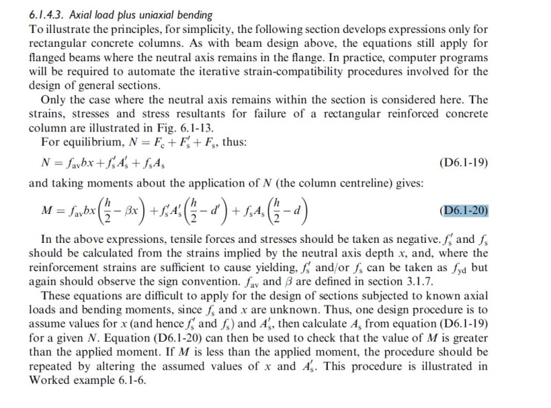

Theres a good worked example in Designers Guide to EN 1992-2 that goes through the procedure but basically as rapt says:
1. Guess the location of the netural axis.
2. Calculate the strain at the relevant location based on your assumption of the NA
3. Calculate the force in the concrete and steel - check theyre the same, if not start again...
Search for Oasys Adsec online I'm pretty sure you can get a free trial, I believe a poster on here also offers a spreadsheet which would also do the job well.

See attached example from some university notes, very old now but should give you some guidance on the process for working it out.
 https://files.engineering.com/getfile.aspx?folder=4918dbbf-2701-4210-9065-880523af6759&file=SLS_Limit_State_(Lecture_Notes).pdf
Like Rapt, I've attached some relevant extracts to help you out as the question was well-written :)
Note that the design is checked to Eurocode 2 but the principle should be the same.
If theres any equations you're missing let me know and I'll hook them out.
