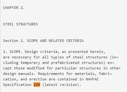

I am currently working on a facility that was constructed in 1968 on a naval base and it refers to "22Y Structural Steelwork" and "13Y Concrete Construction" as governing codes. There isn't any other reference to other building codes, but it does list material codes, such as ACI, AISC and ASA.
Does anyone know what these reference? I'm assuming some sort of military construction code, but I have not been able to find anything online about them and my coworkers don't really know what these reference offhand.
Thanks for any help!

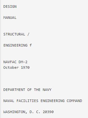

I think the source document for 22Y is via NAVFAC DM-2, which is a design manual that references a specification 22Y
Check out this thread: thread507-315764
Also this link: which is a pdf of a 1980 version of the DM-2.
Saw this text reference on archive.org which references a "specification" called 22Y:

Thanks - that helps me out!
