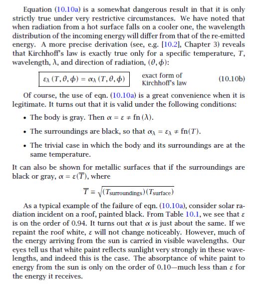

Thanks for that!
OK, I have Leinhard's book but for some reason, my page 533 is different than yours. I've included a screen capture showing the most relevant part. His book warns that the equation ε=α is only used in very specific circumstances and that ε λ (T,θ,Φ)=αλ (T,θ,Φ) is the more general one. I wonder if that last equation could better be written ε(λ,T,θ,Φ)=α(λ,T,θ,Φ).
I'm thinking that no authors are willing to "stick their necks out" to say anything more specific than that. I'm looking for someone willing to say that, for typical terrestrial temperatures with "smooth" organically-finished surfaces within the thermal infrared range 3μm ≤ λ ≤ 100μm, ε=α holds true.
As for the use of the "tance" and "ivity" suffixes for surface radiation properties, on one hand, NIST says that "ivitiy" suffixes should be used only for "optically pure" surfaces but on the other, their scientists and engineers use the suffixes interchangeably.
