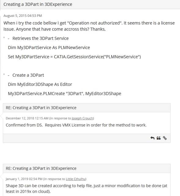

thank you, I really appreciate your feedback , I've already checked this topic, its not what I'm looking for,
ferdo

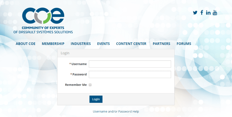

thank you for reply , could you please copy the thread presented in your COE Link, cuz I'm trying to access to the link but the login page keeps me of the thread, I registered but still not receiving the mail containing my password,

@KABEL, please send email to coe@coe.org if you have a problem, they should be able to fix it.

First I'm using catia v6R2013, What I want to achieve is to create PDD (product) then insert (create inside) a 3DD (3DShape);

@kabel...
Sorry I was wrong:
Code:
Dim oVPMRef As VPMReference
Set oVPMRef = oVPMRepRef.Father
is good, it's just that the 3DShape editor is on a shape with no Part or product above, that's why its failing.
I try
Code:
My3DPartService.PLMCreate "3DPart", oEditor3DShape
but I receive licensing error, I know that with proper license it worked because I use this and just copy/paste the part from the new editor to the product where I wanted the instance...
I guess you should talk to your VAR or DS about this...
Can you make a Product template then use it to create new part/shape in your product so you bypass the lic. limitation?
