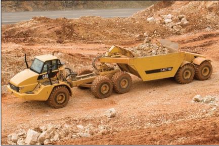

Working on some construction equipment. Basically, a 6 wheel drive dump truck with the bed taken off, and a giant gooseneck trailer hooked to it. Still in setup stages.

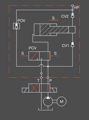

Interesting enough, I also found these just now. You got me going on the intensifer idea. It is really simple and self contained, which I like. See below link.
They reciprocate and have built in check valves, eliminating the need for any makeup oil. Logic is built in.
From what I can tell, there is no way to release the pressure though due to the two uppermost check valves (see schematic).
If I used some sort of normally open pilot operated valve that closes when I supply truck brake pressure, normally draining the TRAILER brake actuator. Use low pressure setting so that truck brake pressure can close off actuator drain, and allow intensifier to build pressure?

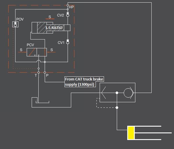

I attached a crude schematic I made of what I am thinking.
I think that the Parker valve that you have will not be what you need. In many of the remote-pilot operated valves, the back pressure at the pilot port is directly additive to the pressure from the spring. I think that a proportional valve would be proportional, as opposed to additive. Additionally, I am not a huge fan of cartridge valves, unless you are very certain that your system will be clean. For me, this always meant additional filtration to the system over what comes from the factory. I have always had bad luck with the little screens inside of cartridge valves getting clogged up with debris. But my experience is in extremely dirty environments with hoses being disconnected and reconnected multiple times a day by careless operators (though who am I kidding - I probably wouldn't be any more careful than they are, were I in their shoes.)
Regarding lock-up of the circuit: You are correct that you would have to vent the lines somehow when there's no pressure on the truck's brake line. It appears that by design, the fluid is intended to only exit through the HP port and not intended to come back in... I think. I don't know exactly how the pilot-operated check valve (POV) is supposed to work in this, since there likely would not be large amounts of pressure on the return to tank line, but I would think that if there is enough pressure, it would open POV and allow reverse flow. That may be the reason that a directional valve is required - to keep back pressure on the tank port, which would open the pilot-operated check valve.
I'm not familiar with the quick-exhaust shuttle valve, but it seems like it could work.

I wanted to ask you this- I have shuttle valves and check valves on handI attached a crude drawing of what I am thinking. Check valve allows for makeup oil ("slack adjusting"), shuttle valve allows pressure to build, but pressure from brake to exhaust to reservoir when pressure is removed.
Am I thinking right, I am a little concerned about the operation of the shuttle ball though- do you think it would reliably relieve the brake to the reservoir consistently in the arrangement?
I want to make your suggestion work, it would make everything so much simpler. I am not against a pilot operated NO valve, but would like to see if this is possible with on hand and easy-to-get parts, I.E. down the road at local cat dealer instead of flying parts in next day air if repairs are needed.

I share your concern about the trailer brakes not relieving every single time. Especially with thermal expansion/contraction, I could easily see the trailer brakes getting locked up.
You could also use a N.O. cam follower valve and have it actuated closed by contact with the moving end of the cylinder rod. I would also make sure that this does not come in contact with the sealing surface of the rod, i.e., make sure the rod is long enough to keep from the sealing surface touching the cam follower. Though a cam follower may not be any more likely to be on hand in a remote location.
