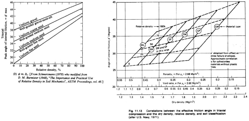

To provide some illustration on compaction effort and peak friction angle i put the figures from Bowles 1997 and Holtz and Kovacs 1981 together. The relative min and max density was probably determined using the shake table procedure.

Thanks for the information guys, this provides insight into the sensitivity of effective friction angle w.r.t. initial relative density (~11-17 degrees). Unfortunately in the Appalachian plateau we rarely deal with the cohesionless soils referenced in the figures. I would expect that the effective friction angle of primarily clay soils/clay, sand, gravel mixes is not as sensitive to relative density as suggested in the plots. OCR is perhaps the more appropriate term w.r.t. categorizing the initial void ratio of the clays. For clays I would expect the level of compaction to primarily influence the effective cohesion. More effective compaction -> higher OCR -> higher effective cohesion -> higher shear strength. Since OCR will vary throughout the embankment/pad even if the exact same compactive effort is applied at all locations (OCR = pre-consolidation pressure [applied by compactor]/effective stress), I may be chasing ghosts with my original query regarding a simple answer to the effect of compaction standard on realized in-situ shear strength.

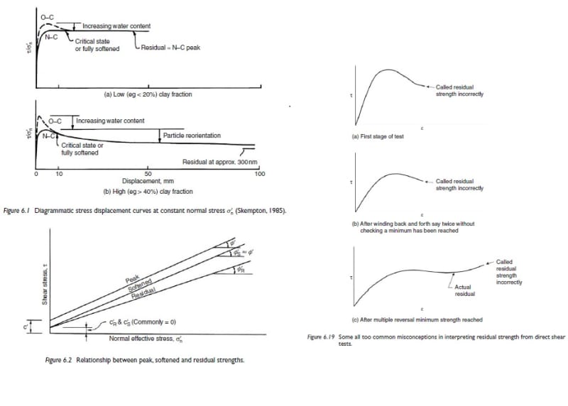

I agree with f-d yes that compacted clays will show a softening behavior increasing water content but also to consider for high clay fraction soils is particle reorientation at high displacements as shown in geotechnical engineering of dams by fell.
Also as you mentioned you are using direct shear tests I would caution you that to determine the residual strength from this test has problems. firstly repeated reversal is necessary and this may destroy the alignment of particles on the shear plane. Secondly repeated reversal can lead to soil squeezing out the two halves of the box or tilting. But the key thing to consider is to determine the correct residual strength as shown in figure 6.19.

"show a softening behavior increasing water content"
I never said this.
Softening is not related to increasing water content. Water content varies during the year. Softening developed from changing water content and the resulting changes in water pressures.
