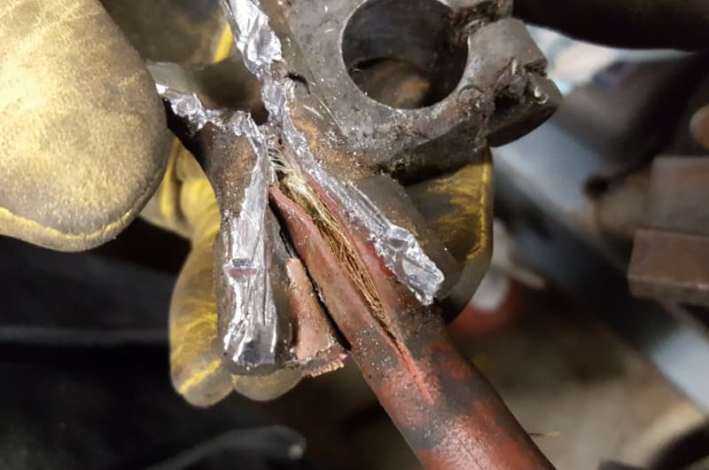

Check this:
For 33 years this clapped-out idiocy of a cable termination started the diesel. Two weeks ago the tiny 1/8" x 1/8" patch of one side of the 3/0 cable finally blew away deep inside the connector during a hard start cycle. Game over. Battery voltage during a start attempt 12.1V. Voltage on Bendix starter stud 0.51V. This defect would've been seen years ago the test procedure described above.
