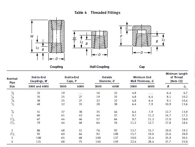

From ASME B 16.11
CAP
PLUG
@As per ASME B 16.11 the terminology is Threaded.
Internal threads or External threads.
"Screwed" does not appear in ASME B 16.11 and should not be used.
Unfortunately many designers don't actually read the actual code documents, but rely on word of mouth or years of doing it "their way"....
Saying caps and plugs have the same function is a fairly meaningless statement, other than to say that a cap is used to close off the end of a threaded pipe, whereas a plug is used to close off a pipe fitting - both function as a termination point.
I am really at a loss trying to see what you are trying to establish, tradition is well established to what a cap is and what a plug is.
