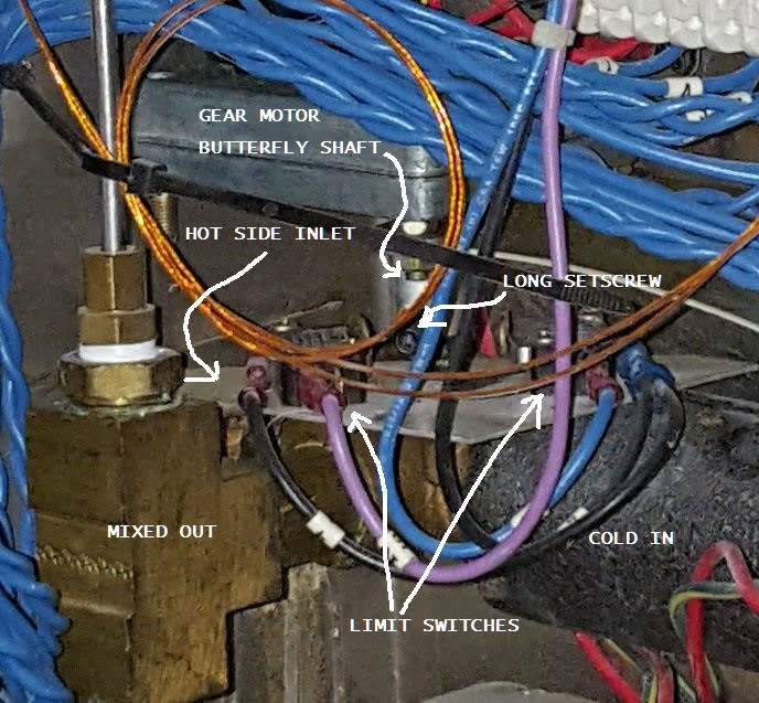

I'm tasked with building a programmable water dispenser for a bakery. I need to provide mixed hot/cold water at a set temperature between about 60F and 110F. My sources are city delivered 55~60F cold water and 140F hot. I need to deliver it in pounds. This happens in about 6 cycles of 4 minutes every 5 or 6 hours.
There don't seem to be a lot of controllable mixing valves out there.
I was looking at lots of motorized ball valves to use for mixing but was finding that they were limited in operation on threat of overheating the motors. Others state lifetimes of "200k cycles".
What's a "cycle" on a three-way valve? Stop to stop? I'd expect these valves to roam around the middle almost constantly while in operation, almost never going to either stop. Otherwise, I can't see these valves lasting a year.
Are there other types or ways of mixing water dynamically?
Should I use two valves and vary them both or just one three-way?

I'll be mixing for a specific temperature UNTIL a specific amount (weight) of water has been delivered thru a hose into a 800lb mixing bowl. So two things are being controlled. I have a dump path available to spew out of, until the temperature requested by the user on a PLC HMI is met, then the flow will be diverted into the delivery hose.
I'm hoping to control the temp so swiftly I can nix the dump and the hassle it brings and possibly keep track of the 'early' out of spec water allowing me to compensate for the low temp early water by delivering slightly warmer water briefly following the 'early water'.
This will be touch-button so no OTS thermostatic valves can work. Nor will the early correction allow a mechanical thermostatic to do the trick.

I hate 3-way valves. I doubt you will find one with a quick enough actuation time to suit your controls. And they are a maintenance headache due to seal wear.
Pulse-modulated solenoids might make more sense, especially if you can track the mixer bowl contents temperature to close the control loop. If you can't track the bowl temperature, and literally are delivering the water through a hose, add an inline static mixer and put a temp. sensor downstream of same.

I'm realizing that, speed not withstanding, ball valves have shockingly short lives. I understand why butterfly valves get used for these type applications now, nothing to really wear out and fast as you can move them.
There is no way to measure the bowl temp, the water's just delivered down a 1/2" hose. The dozen ingredients, about 300lbs are dumped into the bins then the water is delivered. Within a minute or 3 the bins are moved into the mixers and mixed for about 15 minutes. I suspect a few minutes and even a degree or two doesn't materially effect the bread result. It will change the rising time a bit but the rising process is many hours. Once the big hopper has risen it's lifted by a crane and dumped onto a 4 x 10ft table. It's sliced into foot square blocks and dropped in bins to rise longer yet then being processed a bin at a time.
If the hot water is close (recirculated and it is) and control is fast I can see a static mixer and two feet of distance could get the water under control just into the big mixer bowls. Currently they bypass a hundred gallons a day into bins outdoors so they can use it for cleaning. A big hassle really, but they're being good stewards and not just shoving it down the drain.

I'm no big fan of butterfly valves either, but if you realize that they really only on-off modulate (there is a huge hysteresis band in the Cv curve of a butterfly flap) you'll be ok. Seals will still wear over time, but they are generally cheaper than ball valves...but I just noticed the size you wanted, can you even get 1/2" butterflies? For 1/2" valves I'd think a standard solenoid-operated poppet valve (or solenoid-piloted diaphragm) type would be your best bet, these can go millions of cycles before seals need replacement.

I sure hate seeing water lines and valves inside of an electrical enclosure!
