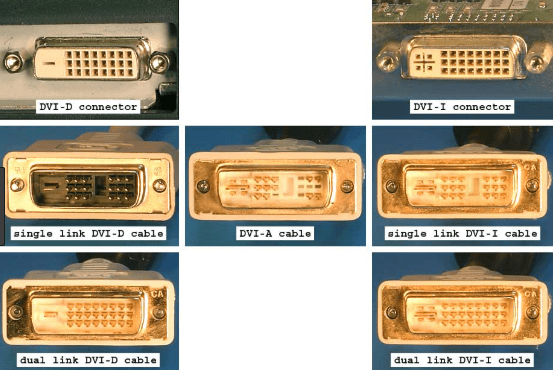

Hi all, sorry about my stupid question, but I have problem with my new pc which I bought 1 day ago. My monitor is VGA-VGA (male-male), my new pc have DVI and HDMI exit only, so I want to know what type of adapter I need to buy HDMI-VGA or VGA-HDMI. I think I need to buy HDMI to VGA, because my logic is that signal is transferred from computer to monitor, but still I'm not 100 % sure. And I think that I don't have possibility to make VGA-DVI because of the type signal, or I'm wrong?
Thank you in advance.
Yes, you need an HDMI to VGA adapter. They come in a bunch of flavors, pick one.

Both HDMI and DVI support analog signals, but not all devices support that standard. You need to go through your PC documentation to see what the PC itself supports.

You are never going to have a crystal clear picture on a digital(LCD) monitor using an analog VGA signal. Now is a good time to upgrade to a larger widescreen monitor with an HDMI input.
However, if you do buy a DVI-VGA adapter or cable make sure it is the correct one for your computer. DVI has multiple flavors, DVI-A(analog), DVI-D(digital) and DVI-I.
The analog signal needed for VGA comes from the 4 pins and the flat bar on the side.
But, t's not really a big issue, since the analog/digital and purely digital forms of DVI connector are not interchangeable.
A 1920*1080 digital monitor can be purchased for less than around US$70, so it's barely worth the effort to get a lower performance analog interface working.

Thank you all for your responses. I bought expensive HDMI-VGA cable model Vivanco 45493 HDMI-VGA adapter for 21 euro, and I'm very content from the quality which this adapter provide.
