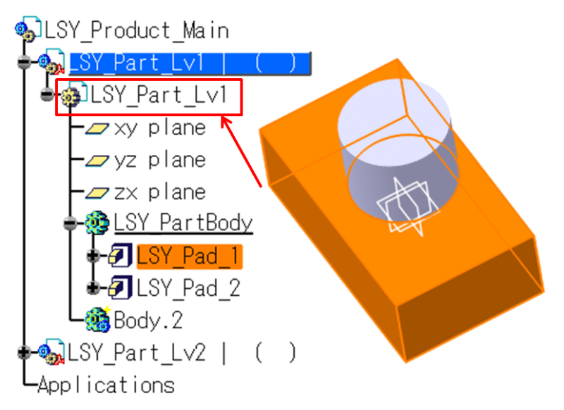

hello,all
If I understand you correctly, you want to get the Part as the red box labeled in the follow picture ?

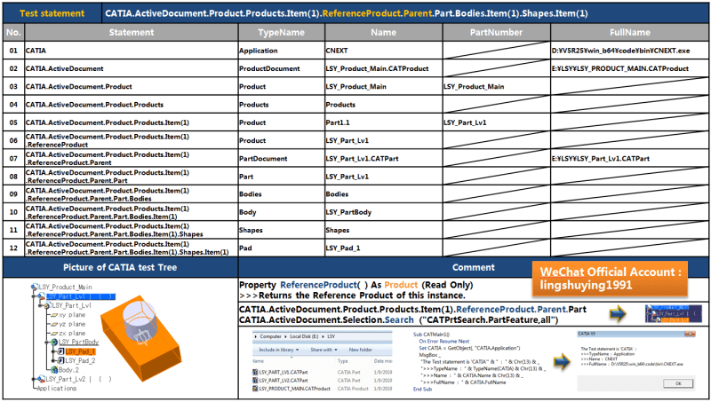

The Following code can help to get Part object from Product :
Code1:CATIA.ActiveDocument.Product.Products.Item(1).ReferenceProduct.Parent.Part
Code2:CATIA.ActiveDocument.Selection.Search ("CATPrtSearch.PartFeature,all")
The following picture may help you understand the code as write above:
I hope it can help you out, thank you!
