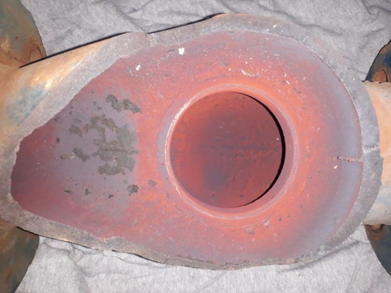

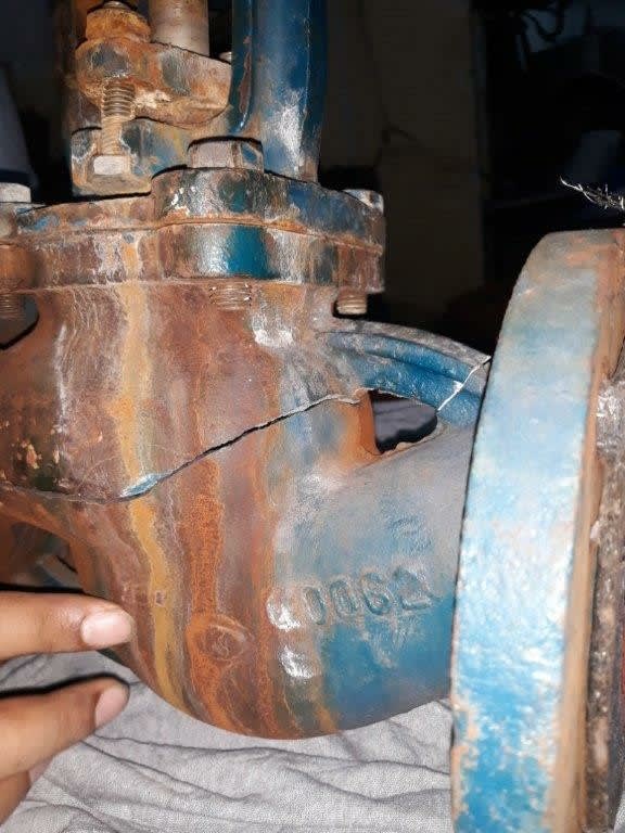

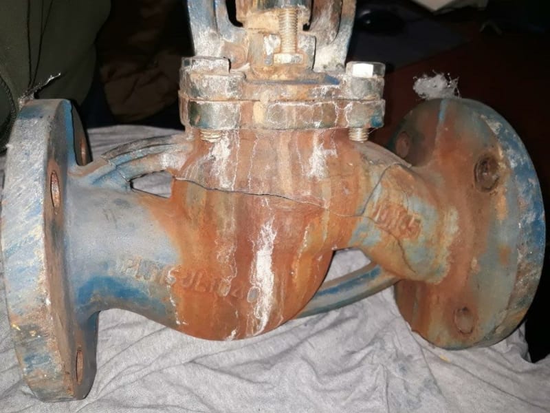

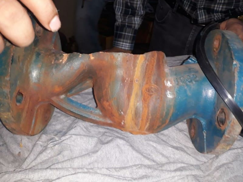

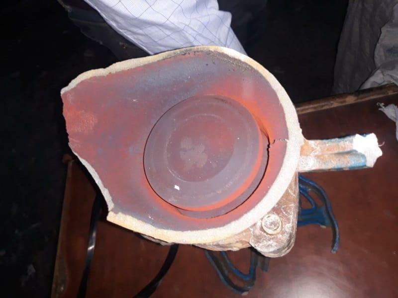

Contact US
Can we get your opinion on attached
Can we get your opinion on attached
RE: Can we get your opinion on attached
Hi Hasham. You can directly post your pictures into the forum using the icon.
That prevents everyone who visits from having to click 2 to 4 times per picture.
You can now delete your last 4 posts and EDIT your first one to remove the link. It will be appreciated.
Keith Cress
RE: Can we get your opinion on attached
I think you need to do a thickness check all over the casting. It may be just the visual aspect of the photo but the one at the top of itsmokeds post above makes it look thinner at the bit closer to the persons arm than other bits of the casting.
Also is that discolouration surface dirt or evidence of a fatigue crack.
Some technical data would be useful
Material
Pressure rating
temperature
Fluid
what happened
Any external bending forces present?
what does the piping around it look like?
Flow direction - Up vertically up or down?
RE: Can we get your opinion on attached
Apart from the wall thickness being not uniform, why is the fracture white?
"Even,if you are a minority of one, truth is the truth."
Mahatma Gandhi.
RE: Can we get your opinion on attached
My theory:
- looks like a 2" globe valve
- looks like some fairly generalized corrosion on both seat and valve plug
- handle is broken
- valve was probably leaking through, and operator decided to crank it down to get shutoff, using mechanical advantage (extreme torque). High torque generated high compression on stem and correspondng high tensile on valve case resulting in fracture.
RE: Can we get your opinion on attached
Good spot about the handle (first photo). Would allow a bit of hammering to take place as well maybe...
RE: Can we get your opinion on attached
Hypothesis:
Corroded valve seat. Valve wouldn't seal properly. Operator applied an oversized wheeldog and broke the handwheel on the first attempt. They then had a second go further round the wheel and the body casting fractured in tension due to excessive seating force on the stem.
Pretty much as Brian said above. Happens from time to time.
RE: Can we get your opinion on attached
I agree with the above posts, although freezing water is another possibility.
Low-Volume Rapid Injection Molding With 3D Printed Molds
Learn methods and guidelines for using stereolithography (SLA) 3D printed molds in the injection molding process to lower costs and lead time. Discover how this hybrid manufacturing process enables on-demand mold fabrication to quickly produce small batches of thermoplastic parts. Download Now
Design for Additive Manufacturing (DfAM)
Examine how the principles of DfAM upend many of the long-standing rules around manufacturability - allowing engineers and designers to place a part’s function at the center of their design considerations. Download Now
