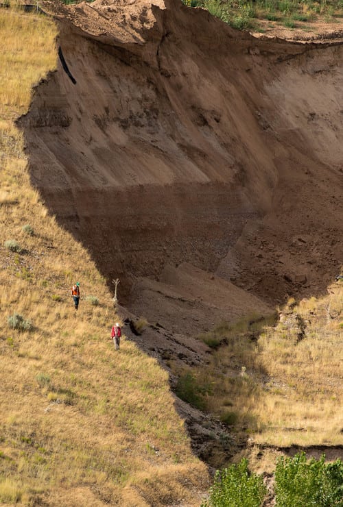

Not so much in the US. But I've pasted an example of a slope failure from 2014 in Utah - less than 2H:1V - where the residents got awfully lucky and just property damage was the result. The good news is that the slide is quite loud and not too fast, and gave residents some escape time.
I'd not depend on a local on-site geotech investigation to predict what is shown above. Since it is very likely this whole area is the same for geology, what is available in the general area locally to look for major movements as the photo shows. Go to see cat's paw erosion areas and see what goes on. For instance at the photos above, were there any recent constructions that affected it? The houses appear new. Ground water many times is in the picture for such slips.
Eaglepoint landslide
apparently this slide was an accident waiting to happen due to geologic conditions which were terrible. this is perfect example why a geologist or geotech should be the one to give an opinion
[URL unfurl="true" said:
https://blogs.agu.org/landslideblog/2014/08/12/eaglepointe-1/[/URL]]The slide mass consists of sands and gravels of the Lake Bonneville highstand, overlain atop Tertiary volcanic tuff – the latter is a notorious material for landslides in the northern Utah, the so-called Norwood Tuff. It weathers to swelling, water-sensitive clays.
The development was a gravel quarry until the late 1990’s, and the area that slid was the highwall or maximum extent of quarrying. It had been graded at 2:1 (~25 degrees). The houses threatened were built in the mid-2000’s.
