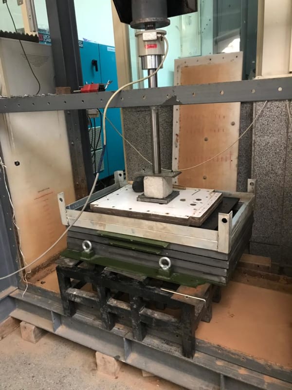

Recently I tried to make a Laminar box that composed several layers. and layers must have moving freedom in X (Longitudinal) direction under load.
to reach this goal I made some Aluminium frames and put flat bearing between layers.
But when I applied load on frames, they Locked and didn't move at all .
why this happend ?

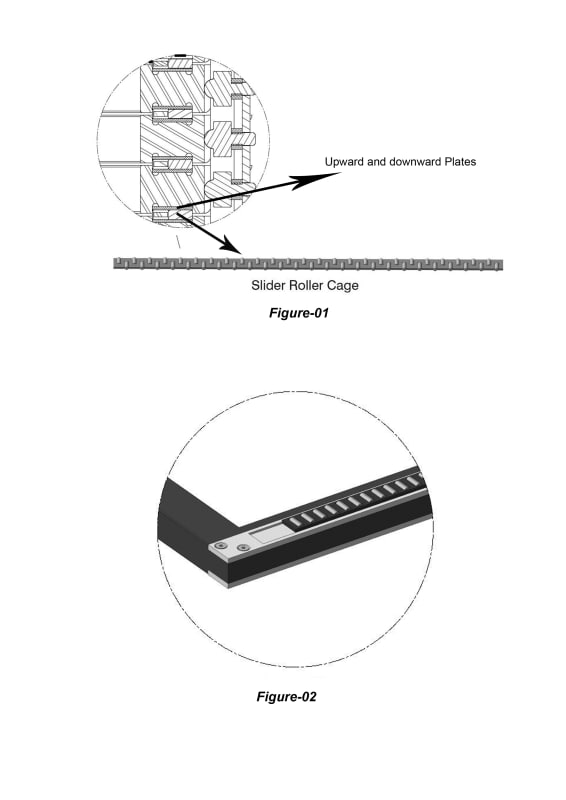

The 2 surfaces in upside and downside of pins are Ck45 plates that we grinding them. so rollers don't touch Aluminium surface and I didn't see any deformation after loading.
How can I find that friction is reason ? and how decrease friction ? because lubrication didn't solve my problem.

By the way I've decided to change the prior design (Figure-01) to new one (Figure-02).
What do u think ?
Cat it solve my problem ?

The maximum applicable load must be 55 Kn, but the layers locked under 10 Kn.
I tried to distribute the load on all over surface uniformly as I could.
These layers are Under hydraulic press. under pressure , as you said, the middle layer must move smoothly (that not happened !)

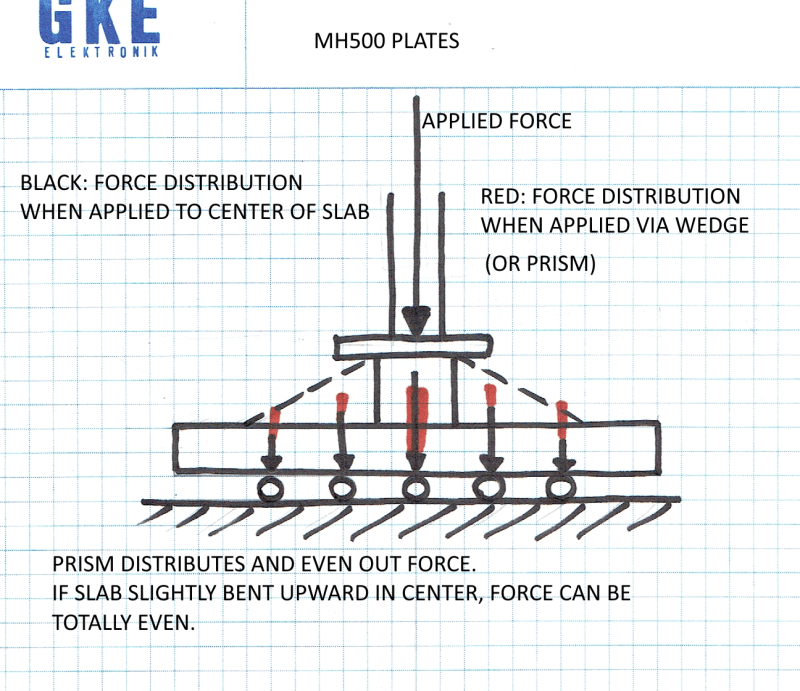

Another point worth considering is the load distribution across the plate. The picture looks like a system with force (the plunger) hitting the plate centrally. That will not distribute load evenly across all rollers. And you just need the roller with the highest force to stick in order to make the whole thing stick. I would try and even that out by applying force via a triangular (and possibly slightly inward curved bottom) member between plunger and plate.

The layers should be close to each other (about 5 mm) . because of that I can not use swivel skates,Linear guides, or something like that.

MH, this is what I meant:
There is a lot of space above the slabs. A force distribution element (does not need to be massive) can help eliminate the local force concentration.
