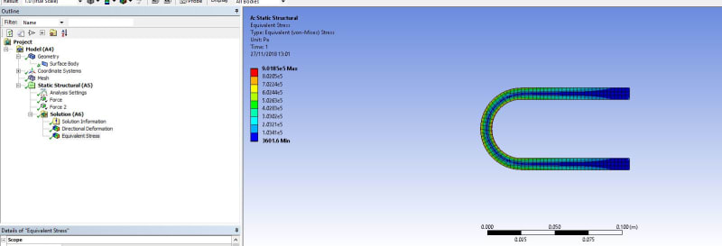

I do not know what you mean with any other software you know (have you actually tried this in all other software). Say in ansys, one can solve this (no restraints, see image below). Since some pivot ratios are zero (FEA does not like that), the pivot checking needs to be turned off and then it will solve without any problems (see below). This was also done for linear static (K*u=F), where the singularity in the stiffness matrix can be severe.
In any case this could be solved in a FEA software that has a dynamic solver (full equation of motion).

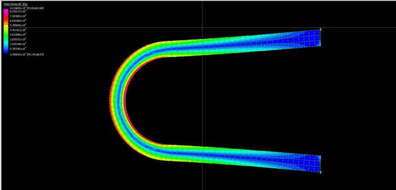

The same problem solved (both sparse and iterative solvers) in Strand7 (no restraints again), again no major issues (second image below).

Yes, say Strand7, one would get a warning about the constraints, if sparse solver is used the pivot ratios will be close to zero and reported, but it will solve (in ANSYS, one would need to tell it that it is OK to have a small pivot, so switch the check off as I said). For iterative solver the pivot is not such a problem (solves differently than the sparse).
So it is all how different software treat these things (some move on and solve and give a warning, some give an error, and stop, and so on...)
