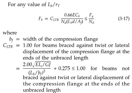

I see lots of references to various papers, but what about ASME BTH-1? I didn't take a close look to see if it directly addresses the issues noted above, but I think if you're designing lifting beams and spreader bars, this document should at the top of the pile of references.
In the BTH-1-2014, they added a Cltb factor to reduce the allowable bending stress and it reads as shown below (note that this is for doubly symmetric beams, also note that eqn 3-17 is for Lb > Lr):
IMO, it's better to keep the rigging at the end, make the beam bigger (i.e., less efficient), use rigging angles above 45 degrees, and go home and sleep at night. If it's a one-off, you can usually sell the user on the feel-good factor. If it's a multi-use (like in a factory), then I'd sell the it's-likely-to-not-get-used-correctly-every-time angle.

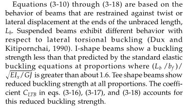

BTW, here's the BTH commentary on the Cltb factor:
