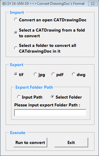

Hi to all, I need to export many CatDrawing to tif.
I want to set a directory for input and output. Drawings may contain multiple sheets
I have 2 scripts (see attachments) that do partially this work.
One script can manage multiple sheets but convert only 1 file and it need to be open.
The other script don't need that the Drawings are open but it don't manage multiple sheets and convert only the active sheet.
Is there a way to "merge" these script to do the whole work?
I don't know vba or scripting so I can't understand if it's possible to do.
p.s.: sorry for my english :p

Hello all,
Here is a more clearly and concisely version of VBA Macro programming I wrote recently,
it can convert all the CatDrawings to Tif or custom select format.
It also has a lot of other features.
1 wish I could help you.
Here is my Frame,maybe you can design an interface that looks better:
Here is my Code:

Maybe you can provide us the .Catvba project or the frame file so we don't have to reconnect the various button to the code.
In any case thank you a lot for your great work.
I like the interface, simple and effective, no bullshit.
Hi, meanwhile I tried to recreate the project with form and the provided code but it don't work.
Something happen but without success.
There's a possibility to hae the .Catvba code?
