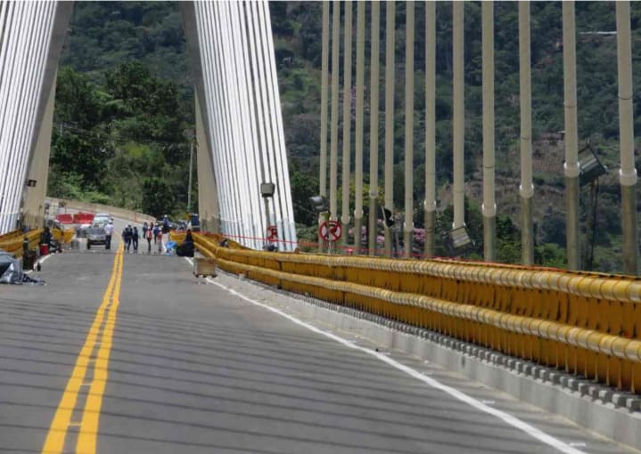

Now we bring the "Hisgaura Bridge" that folds up and down like an accordion.
The national news begins with this document leaked through Whatsapp.
[link Informe Fotográfico][/url]
What do you think ? It's only cosmetic or its form can lead to it's failure.
[link Anexo][/url]
Within tolerance maybe? :-)
faq731-376
Well, a load test should of course be performed, and a very complete and satisfying one. But before, those undulations should be explained and repaired: are they due to an incorrect tension of the cables?
And of course there is a risk of failure, the side beams are under compression and could fail due to the bending and/or instability imparted by the undulations. However to really judge the full static model of the bridge should be known (e.g. where are the expansion joints located?)

Looks like it's a little out of tune is all.
Integrated speed bumps?

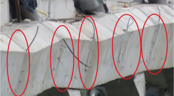

I think the photo posted is misleading. Then undulations seen above are intentional, as seen in the photo below. The concrete is cast with those angles, but the concrete appears to have needed repairs. However, the second attached photo shows the roadway with a rather disturbing cant, as well as undulations.
TTFN (ta ta for now)
I couldn't open the attachment. the accented A appears as a strange symbol which may be preventing download? Try again without it?
that's a very odd picture alright.
Excessive tendon stretch?

What is the problem? The average deck height looks fine.
I can't imagine it is intentional. There is tremendous axial force in the deck/superstructure from the horizontal component of the stay forces. Not having that force in a linear plane would cause immense localized stress at each lower anchorage that was vertically offset from a subsequent one. I've never seen a geometry like that on a stay cable bridge. The deck/superstructure looks "flimsy" (that is an engineering term) for the compressive load, especially from the distant view.

Wow, that's a mess. The only next step anyone should be considering is demolition. Trying to justify it's continued existence by some load tests just seems like a fools errand. If the construction company cared so little about what could be seen, then what else is hidden that could cause a failure in the near future? I don't see how it could be easily fixed. It appears they managed to build a "flat-ish" deck over that rippled supporting structure.
Seeing these pictures better explains how the last collapse happened.
