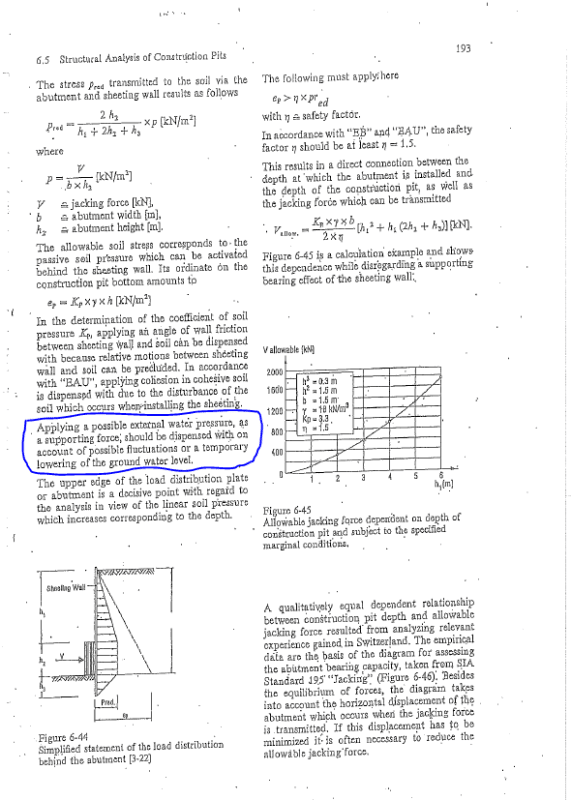

See below extract of a micro tunnel method statement that we are working on. The contractor included this as a reference in the calculations, its obviously from a tunneling book but i dont know the name.
Its states, groundwater should not be considered as it could fluctuate or be lowered with dewatering. It doesn't seem to argue the points discussed above (i.e. sealed or unsealed, dissipation with permeability etc) but i would be reluctant to consider it as groundwater (like most thing in geotechnical engineer) are an unknown. Use a larger jacking wall slab to reduce the force/pressure on your secant piles.
Thanks, EireChch. I've have used a very similar method for designing jacking blocks for as much as 2500 kip jacking force. Gee, I thought I invented that trapezoidal method (LOL).
PEinc - well at least you're thinking like the "smart guys" :)
