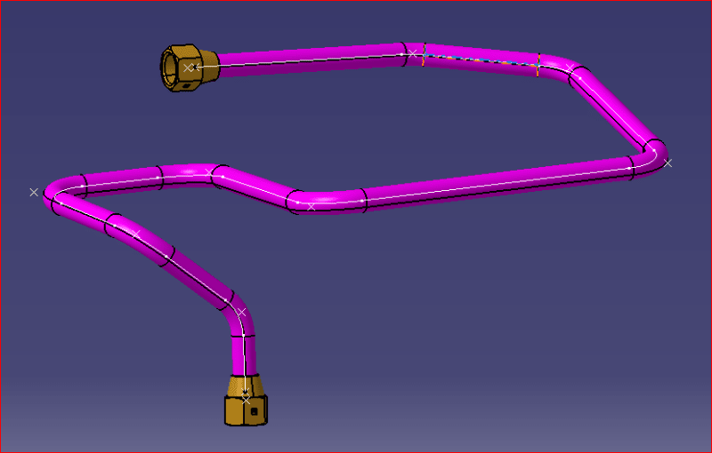

How could I bring in the Catia 2D the centerline font lines that connect the 3D points?
I want to use the current picture as a reference for my task.
Thank you......

I have an assembly:
The task is clear: I need to create a drawing from it.
The ISO View in drawing would contain the chart/map of the points from 3D (please, see the picture use as a reference, in the first message).
The 3D Assembly has its curves/points used for the pipe(tube):
What I want is to create a 2D representation of the pipe on the 2D drawing, for manufacturing reason.
I did find an option: show the points and guide in 3D, then updating the views on 2D (making sure to check 3D Points and 3D Wireframe boxes in the view properties):
Also, I have to "Lock" the view.
But I wanted to know if there is a different method.
Thanks a lot!

Reviewing your reply: " - Show points and centerline wireframe in 3D, then mark in view properties the corresponding check box (points and 3D wireframe), update view.". Do we need to "Lock" the 2D View in order to keep the updates? I am not sure yet......
