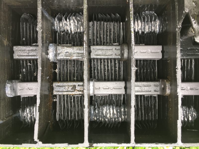

This 12V maintainable lead-acid battery runs in series with another to make 24V to start a diesel fire pump. See photo.
The battery exploded from a gas and ignition source, and evidence points to a explosion when the battery was not starting the diesel.
i.e. simply sitting and being float charged.
There must have been hydrogen gas and an arcing ignition source on the cell cross plate as shown in the photo.
What I am confused about is why this would happen??
I checked the other three batteries (2 more for backup starting) and the electrolytes cover the lead plates, even the exploded battery still has electrolyte over the lead plates.
If anyone has any knowledge on this - would be great.

Defective battery, possibly contamination or bad bonding of a plate. When current is demanded something turns red-hot and a long float can certainly make the perfect gas cloud.
Are you sure all cells are filled over the plates? Just one being low greatly increases the potential problem. A single cell can have bad bonding to the plates. This causes that one cell to be much lower capacity than the rest of the normal cells in the battery. That results in the bad cell having much lower capacity than the rest. In charging it will be fully charged before the rest and start gassing, transporting it's water into gasses that vent causing that one cell to bare its plates.

I just went to site, 3 out of 6 of the cells were covered in electrolyte, the other 3 have long cracks down the plastic cell wall which the acid would have leaked from, so it is too hard to tell if they were submerged or not. From what I can tell the end of the cracks is where the acid level is - so indicates the cells were submerged.
So do you think the explosion requires the battery on load (diesel cranking) to make the ignition source?
See photo, it appears the cast-on-strap is where the ignition source was.
The battery is constantly on a float battery charger - which can make a good gas cloud?
No one was injured made a mess on the concrete with acid.
The plate buckling is a sign of several different possible problems including deep discharge or charging at too high a rate, and could have given rise to stress on the discoloured inter-cell joint which is a credible ignition source for the explosion. Equally it may simply have been a poor joint.
hgordon; I'm with Scotty here in that I bet the battery was being thrashed in some manner. Overcharging can be pretty common. (Hope that wasn't my fire system battery charger design - LOL)
That blown battery strap is definitely the ignition source. Yes, it typically would've taken a start to light it up. To me the inter-cell connection looks pretty lame. A rivet that includes some plastic... <shudder>

You might want to look into the reasons why the plates have buckled. The evidence is there in the battery, have a read up on what it is trying to tell you. [wink]
So looks like buckling is caused by overcharge or overdischarge, or using it in a low charge state, as well as non-uniform distribution of current over the plates. Low electrolyte probably creates some buckling as well.
