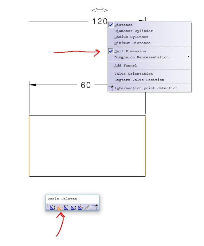

Nov 2, 2018 #1 sudhakarn Automotive Joined Apr 1, 2013 Messages 506 Location IN Hi friends, Got an issue here.When i try to dimension a sheetmetal part,i get double the dimension value with only one dimension line.I have no clue to it.Can anyone pls share your insights?Thanks.

Nov 2, 2018 #2 tesak Aerospace Joined Jul 6, 2011 Messages 141 Location CZ Is it maybe a circular surface? So it is showing a diameter? Tesak http://scripts4all.eu/txtoncurve/ - Text along a curve for Catia V5 Upvote 0 Downvote

Nov 2, 2018 Thread starter #3 sudhakarn Automotive Joined Apr 1, 2013 Messages 506 Location IN Hi tesak, Thats Brilliant.That might be one of the reasons.But what i pick here is a flat edge.Will check it.Thanks a lot. Upvote 0 Downvote

Nov 2, 2018 1 #4 rickyt Automotive Joined Jun 26, 2002 Messages 240 Location US sometime this gets selected! uncheck half dimension Upvote 0 Downvote
Nov 6, 2018 Thread starter #5 sudhakarn Automotive Joined Apr 1, 2013 Messages 506 Location IN Hi rickyt, Excellent!I havent noted this yet. Upvote 0 Downvote
