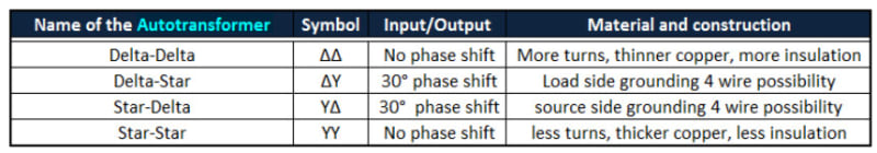

Question 1: Are auto-transformers the same thing as a wye-wye transformer with a buried tertiary (wye-wye-delta)? No. Although the YY connection is the most simple economical and popular, there are other connections as showing in the table below. Buried delta (or stabilizing) buried winding may not be required if neutral loop for zero sequence current is closed & zero sequence impedances of the supplying network are low enough.

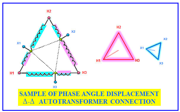

That's basically how I pictured a delta autotransformer, but it certainly doesn't have a zero degree phase shift.
That is one step away from being a phase angle regulator.

One of the applications of D-D autotransformer is to match an existing phase angle.
For illustration, below is an example of the phase angle displacement for a D-D autotransformer
