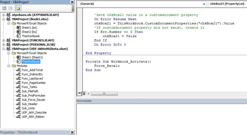

If the forced recalculate works, an interim solution to automate it (rather than pressing a button in the ribbon) would be to wrap up the essence of the ribbon button code into a Workbook.Activate Event. You might be able to isolate just the changing workbook selection (vs other changes) by storing name of current workbook in a global variable or writing it to memory and then comparing it to the newly selected workbook to only then initiate the recalculation, and avoid the recalculate on simply changing sheets within the same workbook (which I gather is not an issue).
See Link, for info on the workbook activate event.
See Link, for how to store variable in memory and retrieve them.

I had been thinking of something along the lines of an event change trigger, but am not sure how I would go about implementing it properly.
I would think that I'd need to have a Workbook_Activate (for instance) sit inside of my XLAM (ThisWorkbook), but that doesn't seem to be getting triggered when switching sheets in another workbook (XLSX).

Your worksheet activate event needs to be in the actual workbook being activated. I'm not aware of any way to place an event procedure within an addin and have it run on a separate workbook. The reason it's not working is you are not activating the Addin, because its simply in the background.
So you would need to turn workbook into a .XLSM and add the code there.
I was playing around for a little while after work and found a couple of pages about event handlers.
I put an event handler and a connector macro (whatever that is) in the XLAM add-in. And I was able to trigger them by events (changing between worksheets, etc.) in a separate workbook (XLSX) and automatically run a simple macro residing in the XLAM.
The "issue" that I kept running into was that I had to manually run the connector macro every time I closed and restarted Excel.
So I want to look into that more when I have the time and ambition.

Have you tried calling the 'connector macro' from the Addins workbook_open event? That will run it every time you open excel.
Sure. I'll post an Excel file or a copy of the code when I'm back in the office on Monday.
I haven't played with the connector, yet. I was just happy and surprised that I got the events triggering, but I'll have to look into the workbook_open route.
I added a code module and CLASS module to my XLAM project, but I imagine you would get the same results from putting them in you PERSONAL.XLSB.
I added the events that I want to trigger in a new class module.

And then I added connector macro in a typical code module. For some reason, so far, this macro needs to be run every time excel is started in order for the events to trigger in the class module.

Once you create the event application (I called it myAppEvent) in the class module, you can select it from the LEFT DROP-DOWN menu and then all of the available procedures can be selected from the RIGHT DROP-DOWN menu.
