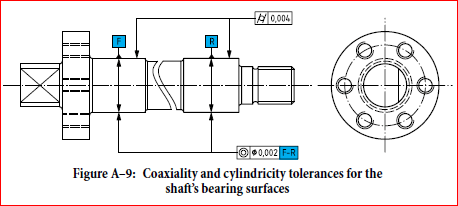

Picture from an ISO book.

Nonetheless, here is another example where form error is bigger than location.
Does the cylindricity in Kedu's first picture looks kosher?
Size tolerance is smaller than cylindricity.
Also has E envelope symbol shown.
