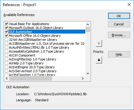

I get the same error as you running it under excel, so perhaps you don't have the required references loaded into the project or are missing one, refer under tools/references? (FYI I have the following enabled if it helps)
Agent666,
Thanks for trying on your machine at least I know the code works. I did check my settings and they were the same so removed 365 and reinstalled with no luck.
