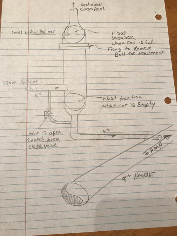

Sounds like you need something like a float valve inverted. Here is a sketch of a canister that you would put between the 4” rail car hose and 8” header. The canister would have a float in it of appropriate SG less than the product. There would be a valve that would start open to allow the bypass to flood the canister and lift the float. Hook up the rail car and shut the valve, move to the next car to hook up. When the first car empties, the air in the canister allows the float to fall and block the suction.

Wow, SandCounter, that is a superb solution to the problem and more elegant than what I may have suggested. That is far more than a tip; it is free engineering. I hope it is appreciated.

This is a great idea and one I had not thought of. For solving this problem, I had always thought I needed some sort of valve which would detect when there is no flow and then would close. I have dealt with a few vendors discussing this idea, but yours had never come up. This is an excellent idea. The rail cars do vortex as they get lower, and some air would still be entering the system before the railcar empties. Would this cause the ball to prematurely drop, therefor closing this valve? I assume at that point we can open the bypass valve and restart the process. But at least at that point, the pump would no longer be drawing air, which is a huge help. I will continue looking into this and provide an update when I learn more.

This float valve @soundcounter suggests looks a lot like the liquid drainers commonly installed on wet compressed air receivers to drain out water condensate. This also require a level equalising leg from the source vessel which ties in to the drainer body. In theory, this appears to be a great idea for this application, but liquid drainers I've come across are low capacity - high pressure drop, and you need something like 400-500gpm at a low dp for each drainer, so that npsh is not affected, so that is something to check with vendors. Very often, the ball float in these drainers seizes up with corrosion debris / dirt, and plant operators revert to the drainer bypass line, so a y-type strainer upstream of the drainer in this case may also be required. Good to hear you are making progress on the suction line PT / PIC resetting pump speed control loop. If the vapor space pressure in the railcars varies somewhat during the unloading operation, level in the first railcar can only be reliably inferred by dP between railcar bottom drain nozzle and railcar vapor space (since ethanol density is known), so the control loop would then be dPIC resetting pump speed.
