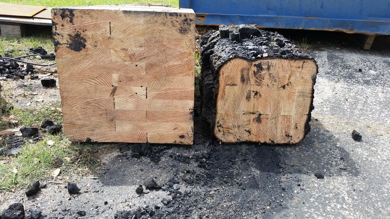

Steel weakens drastically with heat and it will get hot quickly if expose to a decent fire. So if you have a beam lose 80% then you can imagine the results.
Timber will burn but only the timber that is expose to the air. It will charr and that charring will insulate and protect the inside from burning nearly as rapidly. The inside stays intact and maintains its structural integrity.
Of course if your building is based on toothpick then it will go up in flames like a good bunch of kindling. But if you have decently thick structural timber members then you can get impressive fire resistance out of them.
Glue-lam is fine if it is the good stuff. The good stuff has impressive fire ratings:
Human909... your Young's modulus also decreases dramatically... another part of the problem. Charring helps, but I wouldn't rely on it for too long...
Dik
Dik, wood burns at a predictable rate. So you can calculate an estimate for how long it will hold the load. Exposed part of the section of course doesn't have any stiffness, but unburnt core has much lower temperature. Charred layer will insulate the core always as it burns, you don't need to rely on anything.
Yes, I've had non-technical people balk at the idea that a wood framed building is considered fire 'resistant'. Granted, it might not be fire 'proof', but, as seen above, structurally, it may be able to survive better than a steel frame building. In fact, I had a veteran firefighter tell me once that if he had to enter a burning building, he feels safer inside a wood structure than a steel one, because as he said, the wood building will give you a warning when the beams are above to fail as you can hear them crack and splinter while a steel building will simply collapse with virtually no warning whatsoever.

Not fire, that’s my understanding why Poplar is the preferred material for supporting mine tunnels. Not the strongest material, not the easiest to find or work with, or anything else like that. But rather because it fails slowly and noisily.
