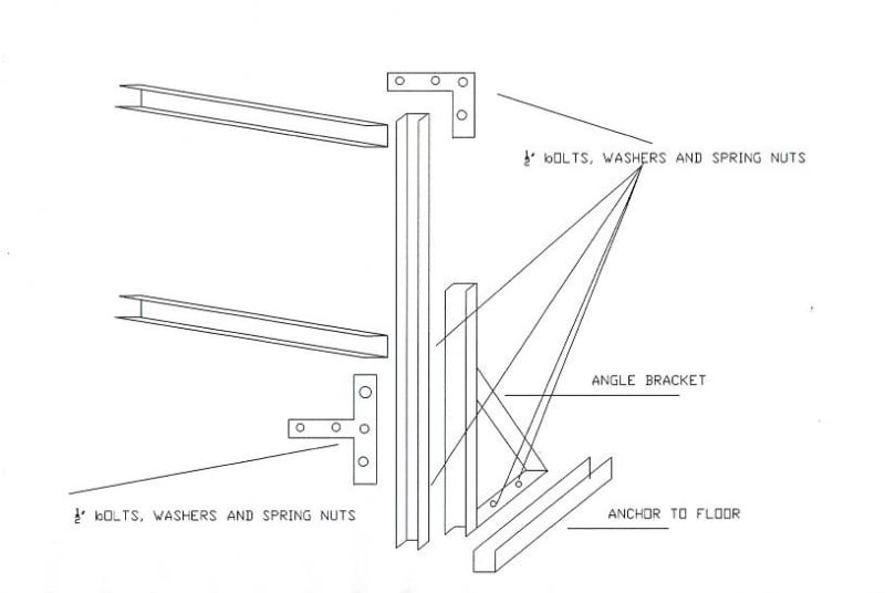

Hello,
We are installing a generator to back up some building system loads as well as an existing fire pump. The separate fire-pump rated ATS is needed to be installed on a cantruss stand instead of being wall mounted adjacent to the fire pump controller, due to the unavailability of wall space in the mechanical room.
I wanted to inquire if there are any pre-fabricated or apprvoed stands available in the market which could be used to mount ATS?
Thank you.
Hi. I spent some time on your problem. I have a sketch that may help. I have to transfer it to another computer to scan and send it. I will try to make time to get it off tomorrow morning.

I apologize for the delay.
I had some issues scanning the sketch, and then it was a rodeo weekend.
Here is a sketch based on standard Cantrus components.
Shown is one end stand of two or three.
Check the Burndy catalogue for available components.
[URL unfurl="true"]https://res.cloudinary.com/engineering-com/image/upload/v1535381941/tips/ATS_SUPPORT_dumd7s.pdf[/url]
