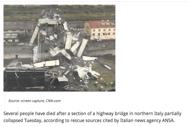

"...after a section of a highway bridge in northern Italy partially collapsed Tuesday,..."
How can someone possibly use the term "partially collapsed" right under that photo:
And they can't claim that they were saying that only part of the bridge had collapsed since they had already qualified their claim by saying that "a section of a highway bridge". Just poor reporting or poor editing, take your pick.

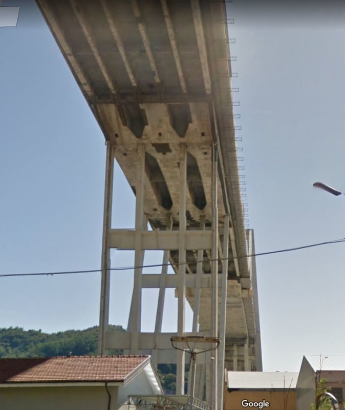

Interestingly, if you go to Google street view and ride across the bridge, the S/E span has external P/T strengthening up the length of all four concrete stays. The other main spans do not including the one that collapsed. There was work going on the north side at the deck level, but it looks like barrier rail work so may be unrelated.

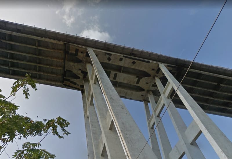

A unique framing system for sure based on some photo views from under the bridge:

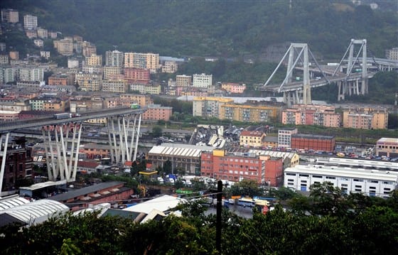

I don't think the cable-stayed part of this bridge fell down - it was the first pier beyond the end of the cable stays that appears to have failed - or the deck just adjacent to that pier.
From the photo posted by bimr above, the two cable-stay assemblies are still standing.

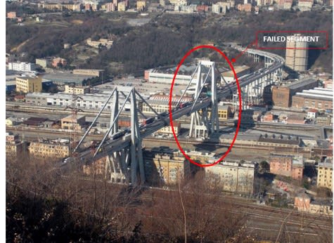

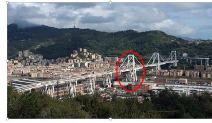

JAE, there were originally 3 towers, according to the pictures I have seen. One of them fell. Of course, It could have been a number of failures not associated with that tower. Preliminary reports say there was 'shoring' being done, and a tower crane was employed for maintenance work, but I haven't seen any evidence of a crane yet.
