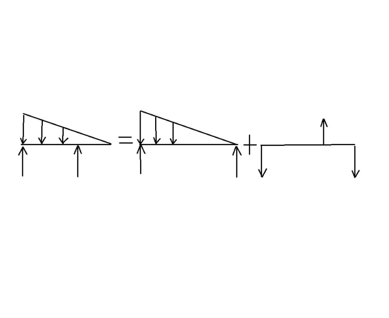

Does anyone know what's the deflection formula for a beam overhang one support for a triangular distributed load over the entire beam? Beam is supported by two supports.
You could superimpose two load cases, one with triangular loading and simply supported at ends, and one simply supported with concentrated load at arbitrary point, to get the total deflection.

principle of superposition can still be applied. You'd have 5 more sub-sets in addition to original ones I have shown:
left cantilever as free-fixed with triangular load
left cantilever as free-fixed with uniform load (assuming a triangular load peak at left and 0 at end of the right cantilever you will have a trapezoidal load on the left cantilever and center span)
center beam with left cantilever triangular load moment reaction at left end
center beam with left cantilever uniform load moment reaction at left end
left overhang with rotation from center span considering all loads applied to the center span

It should just be two load cases superimposed, and both cases should be in the AISC manual or Roark's- calculate the intermediate load to make the reaction at one end go to zero.

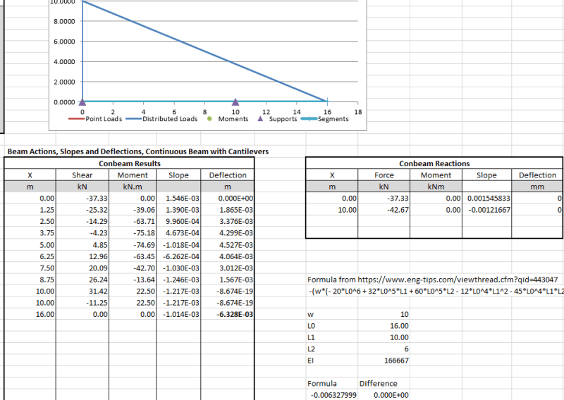

From virtual work, the deflection at the tip is:
Delta = -(w*(- 20*L^6 + 32*L^5*L1 + 60*L^5*L2 - 12*L^4*L1^2 - 45*L^4*L1*L2 - 60*L^4*L2^2 + 20*L^3*L2^3 + 10*L^2*L1*L2^3 + 3*L1*L2^5))/(360*EI*L1^2)
where
w = max uniform load at the left end
L1 = backspan length
L2 = overhang length
L = total length = L1 + L2
I checked this using two cases in SAP2000 and it worked.
Please check to make sure you agree before using it.
It agrees exactly with my spreadsheet.
Spreadsheet attached.
