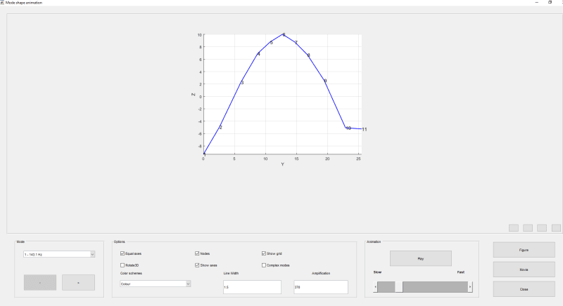

Actually I can plot the mode shapes within the toolbox. The animation of the mode that I get within the toolbox looks like this:
However, I have to save the mode shape vector and plot it outside the toolbox environment. But in that case I don't know how to deal with modes that come as complex numbers.

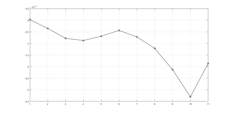

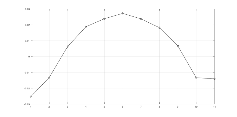

I have followed your instruction: "I suppose the other option is to plot the real and imaginary deformed shapes separately"
and for the plotted mode in Macec I have calculated the real and imaginary part.
This is the plot of the imaginary part of the mode shape vector:
And this is the plot of the real part of the mode shapes vector:
Does it mean from the above plots that I can actually use the plot of the imaginary part of the mode shape to represent the actual deformed shape?
And why the plot of the real part looks like this?
Is it common to get the deformed shape that is close to the actual deformed shape for that mode with the imaginary part instead of real part?

Yes, in a normal modes analysis the resonance occurs at a 90 degree phase shift, so the imaginary part is the mode shape. In real life this occurs with simple systems such as a steel beam or plate. As you add complexities like point damping, clearances and so on then the phase plot vs frequency becomes much more complex, and the imaginary part of the response is not necessarily the important bit.
