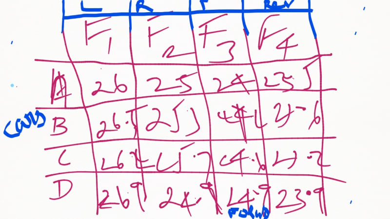

Dear friends,
I wish to share some good news that i was able to iteratively vary the frequencies in the 4 RC Cars by varying the variable frequency transformer. And I succeeded decently. They are not interfering now. But, when they are very near there is a few cars interfere. But, i am happy to note something working now.
i Understood more on what is happening in these chinese cars that have been built for 27meghz.
The 4 channels operate in diff. frequencies ( L, R, F, R). Since each has a set freq. thr. the circuit design with SMD Components.
The freq. transformer upon varying . it varies this set of 4 frequencies already set.
A meticulous variation gives a stable change and that is not repeated by the other one. When they are near to each other sometimes they interfere.
But, more than 4 for some reason, the frequencies are not changing and very tough to do it.
Note: I adviced an electronic person and he did it for me though and carried out what i wanted.
I had attached a sample template of frequencies for the four channels and a sample values ( tentative only not correct, since i do not have a Scope for this purpose.
