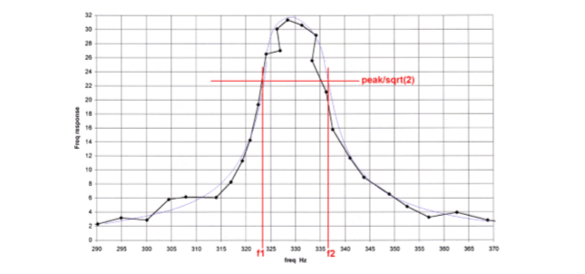

I will assume that you do not have any modal tests where modal damping has been measured, so in this case if you have the material damping (e.g., 0.25%-1%) for cast steel alone (no welds no bolts no connections ...) then enter the material damping coefficient GE only (not both).
If I am wrong and you have measured data and obtained modal damping from exp. modal analysis, then input the modal damping directly only (not both).
In any case you can check that you get the actual damping by doing a harmonic excitation study sweeping a harmonic force over frequency. In this case you can plot your frequency response as shown below (e.g., velocity/Force), over frequency and from that you can get the damping via, damping (%) = (f2-f1)/(f2+f1). This should match whatever you put in to the software.
Also try to move the natural frequency of your part away from the external loads excitation frequency, so not to rely on damping in order to get an acceptable structural response.
