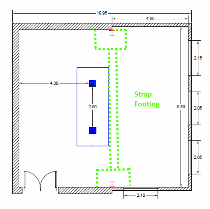

Please find the link:
The existing column and foundation are drawn in blue. The new beam and column are drawn in red. The new foundation is drawn in green.
I can't remove the existing column and foundation before the new foundation and steel frame is completed. So while constructing the new foundation, it will interfere with the existing foundation.

Please find the link.
I recalculated and the dimensions of the new footing resulted in a square shape (3.05x3.05x0.5)m.
First I thought you meant trapezoidal footing, but trapezoidal didn't solve the problem. So I tried putting the column on one corner of the square footing. I appreciate any thought it may arise.

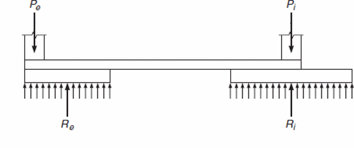

hoshang - If the loading on the new footing is from the new columns, like shown below, none of the footings proposed will work correctly. The load has too much eccentricity:

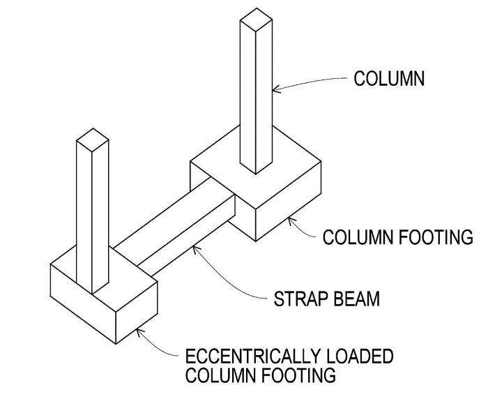

If my sketch is correct, a "strap footing" should work. The strap footing would be like the drawing below, except that both columns will like the "eccentrically loaded column footing" in the drawing.
Your plan may look something like this:

Thanks. A strap footing is the solutions. Bowel states that in such cases of mine strap footing "must" be used.
