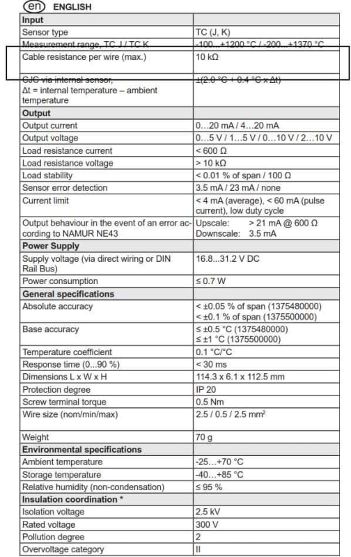

5) Amplifier (Weidmuller act20m-tci-ao-e-s) Maximum lead wire resistance = 10 kOhm per line. I agree this is a very strange spec.

danw2, responses below. Again thanks all for your assistance I really appreciate it.
danw2 said:
That 10k ohm per line spec for the input leads of the transmitter is a really fishy spec. Most T/C transmitters get uncomfortable at more than 200 ohms of lead wire resistance.
Agreed. Not sure what to do about this. If anyone cares to follow the rabbit further down the hole, the converter is a Weidmuller ACT20M-TCI-AO-E-S.
The Weidmuller spec sheet does not cite the input resistance on the T/C side (at least I can't find it on the single page spec sheet where one would expect it).
The cited 10Kohm value is the minimum resistance for the receiver's voltage input when using the voltage output on the transmitter. It doesn't apply at all because you're using a current output.
In the absence of an input resistance spec I doubt it is 10Kohms, especially on a low cost, non-isolated temperature transmitter, given the market's preponderance of specs in the range of 100, maybe 200 ohms.

It is not clear what that module does for cold junction (CJ) compensation. Terminals 1 and 4 are marked for CJ but are indicated as 'optional'. Optional CJ? CJ is not optional for legitimate thermocouple thermometry, if the temperature numbers are supposed to mean anything.
So you've got
- a 4 wire non-isolated (it's not just the lack of input-to-output isolation; notice that the inputs are not isolated from the power supply, how handy) converter
- 2.4Kohms of lead wire resistance on the input of the transmitter
- dubious cold junction compensation
- 500m of T/C lead wire that is not shielded, so it's not likely that it is twisted pair, either
Typical practice is to make the long run copper wire, not only because copper's cheaper and more readily available, but because 4-20mA will drive substantial loop resistance at a nominal 24Vdc, even 24G CAT5, without blinking. And installers use shielded twisted pair as standard practice, for noise shielding.
You can mess all you want with the DC power supply to try and fix this, but the architecture violates measurement basics. Good luck.
