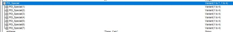

I am having problems sending an array into an excel function. I also may be having problems getting an array back out.
I'm trying to call a function named "Stem_Wind" and am passing several variables to this function. One of the variables is a 7x4 variant array.
After the function runs some calculations, the output of the function should be a 1x2 numeric array.
I think I have issues passing variables in to the function, but I probably have issues getting them back out too :(...
Attached is the code... I can send more in text format if it helps.
Thank you in advance.

Where does POI_Special come from? Are you sure it is a variant array, rather than a variant/range?
But I think your problem (at least one of them) is declaring the function as a Double array. Try changing:
) as Double()
to:
) as Variant
or just don't declare it, as Variant is the default.

Thank you for the input. I deleted the function declaration.
I get a compile error at this line.......
[highlight #FCE94F]POI_Stem[/highlight] = Stem_Wind(PointX, POI_Special, h_topfence, h_parapet, pressure_wind)
It says 'you can't assign a value to array'
'POI Special' is definitely an array. It contains special points of interest on a retaining wall where equations will change. (such as top of wall, natural grade height, top of footing)
OK, I should have noticed the POI_Stem declaration.
The message 'you can't assign a value to array' is pretty misleading. You can assign a function return value to an array, but you have to declare it as a variant object, without specifying what type of variant it is; so leave off the ().

Dim POI_Stem as Variant
You then need to declare an array inside the function (say Dim POI_StemF(2) as Double), and the final lines of the function will be:
Stem_Wind = POI_StemF
Exit Function
Alternatively, you could pass POI_Stem as a function argument, and add the required values directly to POI_Stem, rather than Stem_Wind. The function return value could then be an error index (or even nothing).

IDS.....you are genius!! It worked!!
