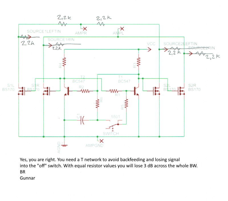

I'd like to toggle between two sources of stereo audio (each having L, R and Neutral). Who can help ?
I'd also like to do that using one of those basic bistable on/off switches
- And more important, if possible: basic components only. No extra ICs apart from OpAmps, Schmitts and drivers that I happen to have laying around this time.
I not only don't have ICs at hand: they tend to degrade the quality of the signal if I don't buy the right one.
- I have not negative supplies, in case OpAmps be suggested
- Part count is not so important
- If transistors are required, BJTs are preferred
- I'd like to avoid relays too, although they will be my choice if none of the brilliant minds don't find an option that fits the criteria above
Thank you ahead for your time
What voltage levels are involved? If one or two V peak, I would try a series resistor, say i kohm, in each channel to start with. would then use FET transistors from resistor to groound. And then Control each FET from collector of TR1 and TR2. The FET with Gate high will then short signal to ground and the other one will be HiZ and let the signal through. BJT:s are not as symmetric as FET:s are. FET:s can short out negative signals as well as positive ones.

Now, Skogsgurra's solution seems the ideal solution for the moment, but I have a question about this arrange:
Won't muting a source (grounding it) also mute the other ?
Both sources go to the same amplifier in the end
I've attached a sketch of the propposed circuit. See if it's understandable, and if it represents what you pictured. Please suggest corrections, if required.
Don't mind the astable part
Yes, you need resistors, too. See Picture:
May have been too quick, you lose more than 3 dB. But this is the simplest way - with the resrtictions given. If you make the T assymmetric, with 1 k in and 4.7 k to amplifier, you lose a lot less than 3 dB. The BS170 has around 2 ohms channel resistance when on. So isolation will be adequate even with 1 k in. Something like -63 dB. I think.

A bistable relay would solve everything in the simplest manner.
Relay it is, then
