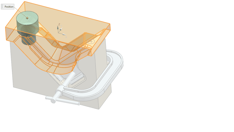

1)How can I get this (through preview view) in hole command.
except this
I had adjusted view settings but nothing happened.

In NX12.0.2 the hole command shows a transparent preview for me

I am also having this problem of the preview not showing transparently! It is intermittent for me though. I was able to get the preview to show correctly by showing the part in its own window, where previously I was trying to add a hole to a component in an assembly, but other components in the same assembly show the hole preview normally when the assembly is the displayed part!

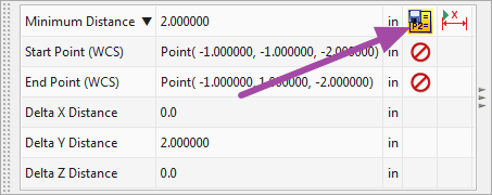

I was able to do Measure inside of command ( like move objects or move face etc) and when Iam done with measurement, the value used to pop up in the field automatically in NX10..
In NX12, I cannot make it work.. I have MP4 installed , but still does not work..
Any ideas how I can get back this ability?
Did you click this button?
Your dialog may look different but the button will look the same in different results windows.
