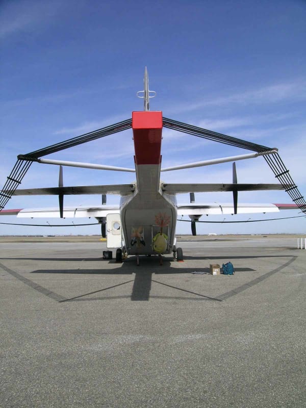

Here's an example of what's going to be built (not our aircraft, not our customer, not our instruments, but the same idea, attached to the FUSELAGE):
STF

I had a customer many many moons ago that operated a "clothesline" CASA 212 with these hanging off the back. Made them up a new cradle for the fat one.
Google "tem aircraft survey" for more about those guys.
