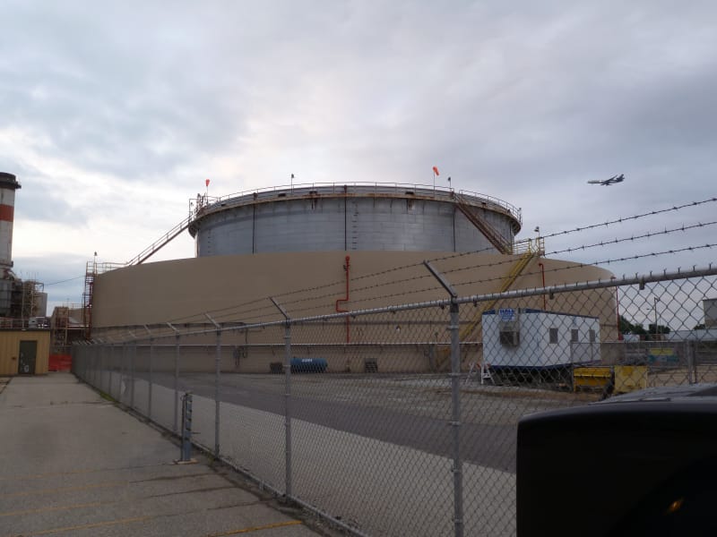

It's not at all unusual to have a circular steel dike with a storage tank inside, particularly in and around large dense cities where land is very expensive. I worked on a 150 foot diameter tank inside a circular steel dike and several smaller one. Because the dikes are larger in diameter they are seldom the same height as the storage tank.

Here is one - a 150 foot diameter tank inside a steel dike.
I'll look for others...
Wow, that's a nice tank.
My point is that this is, in principle, no different to a "standard" bunding arrangement, just made of steel and much higher than "normal"
The OP seems to be looking for a large (3 to 5,000 m3) vertical double skinned tank. Now that IMHO, is pretty unusual...

Thanks for providing the photo, like to know the service fluid of the tank.

It's not a double wall tank. It's a tank inside a steel containment dike. There are no rules specific to this type of dike construction that I know of but I was not involved in the design or construction of this one. There is no need for an earthen dike or bund around the tanks. I don't think the fire risk is higher for this type of containment than a much larger but lower wall around the tank. Surface area is less which might help. Its purpose is not to stop fires but to contain a leak (or a fire) so it does not spread to neighboring areas. That tank was in ethanol / gasoline service, my job was to put an aluminum internal floating roof inside. Most of the tanks I've seen had much less distance between the tanks. I believe NFPA says the dike must be at least 5 feet from the tank, I have worked on tanks inside concrete dikes where this minimum space was required. There are some piping issues that may require a larger space between the tanks, especially if the thermal expansion of the piping is significant. Thermal expansion in the piping can transmit large forces, tank nozzles are ill equipped to resist large forces and moments. The outer steel dike is essentially just another tank and is designed using the same codes and calculations as the inner tank. Most of the steel containment dikes I have seen are open top, a few have a sloped roof to shed water and snow but then the space between the tanks has different conditions and risks. I have put floating roofs inside actual double wall tanks - one inside the inner tank and one in the donut shaped space between the tanks, they were surrounded by a containment system, I think an earthen dike.
