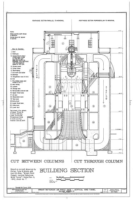

Hi, I will like to design this vertical wind tunnel (large nozzle) to shoot air out at 10 m/sec at the exit and a diameter of 8 ft vertically downwards.
However I want to understand the following parameters. Does anyone know about this? and know how to calculate the following parameters ?:
We want V2=10m/sec (outlet velocity at jet)
I want to design a fan or number of fans arranged (or framed together) that can do the job and how can these fans be selected?
How can I calculate the inlet flow Q1?
How can I calculate the inlet velocity V1?
The required outlet velocity must be 10 m/sec, The outlet diameter is 8 ft.

Suggest you famialiarize yourself with basic fan laws and then cut your list of questions down to perhaps four. Nineteen questions is a bit excessive for a forum like this and your project will likely have substantial capital costs...... not an ideal scenario to start learning the basics.
I am just familiar enough with one of the oldest vertical wind tunnels (1944 @ Wright-Patterson AFB, OH) to know that you are taking on a daunting project. You may be able to find some guidance using the specialize search engine Google Scholar.
