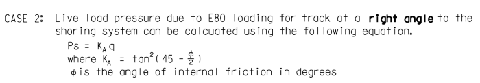

I'll help you chase down the Guidelines For Temporary Shoring. Suggest downloading immediately and going to "Figure 2"... which solves your problem. (A little purple star to GPT, from me). Here it is, in part:

Thanks for all of the input and I'll followup on all recommendations. FYI.....see attached spreadhseet for lateral load called "wallpres" from Alex Tomonovich. You may already have this but thought I would include if you need it. Appreciate the heads up on the soil settlement issue as I will examine this closely. One option would be backfill with stone for an area 20' x 20' x 40' to minimize settlement at this location. Using the grade beam or thick mat this location would certainly help both settlement and remove the large lateral surcharge from the engine. Currently looking at approximately a 5'-0" thick retaining wall with #10 @ 6" c/c. Soil moment is about 80 k-ft using Ka=0.5 (conservative)then add the locamotive loads. Depending on your approach....add up 5 or 6 point loads and resulting moments or using the 8 klf strip load you can end up with 170 k-ft from the locomotive. Then multiply by 1.5 for impact and then by 1.6 to get to ultimate loads and you end up with 408 k-ft from the locomotive. Then add 80 k-ft x 1.6 = 128 k-ft for the soil. Total is 536 k-ft......so 536/(4* 57) = 2.35 in2/ft....or #10 @6" c/c. You are right.....loads are massive.

Looking at your sketch, that's an E-60 load (you are calling it a "E-80"). The Cooper load spacing is the same regardless of magnitude. But the magnitude will vary. For example a E-10 loading:
You see the rule for obtaining any Cooper load you want.
As far as your lateral pressure goes.....I've always thought AASHTO had some good help for transforming point loads into lateral pressure: see Figure 5.5.2C (in the 16th Edition of the bridge specification, p. 120).
For AASHTO, if highway traffic can come within a horizontal distance from the top of the structure equal to one-half it's height, they cover the additional pressure with a 2' surcharge of soil against the wall. In your case however, you have loads well in excess of the 32k axial loads for highways.....so that would probably not cover you.
