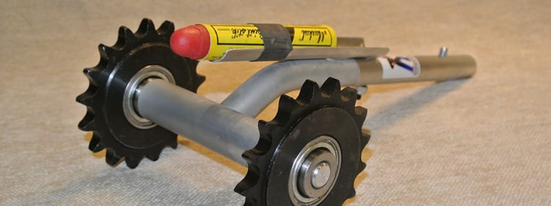

I purchased one of these about 20+ years ago. Works real well - and very quick. Especially good for overhead soundings:
From Sounding Technology: Link
Not associated with them - just a happy user.
