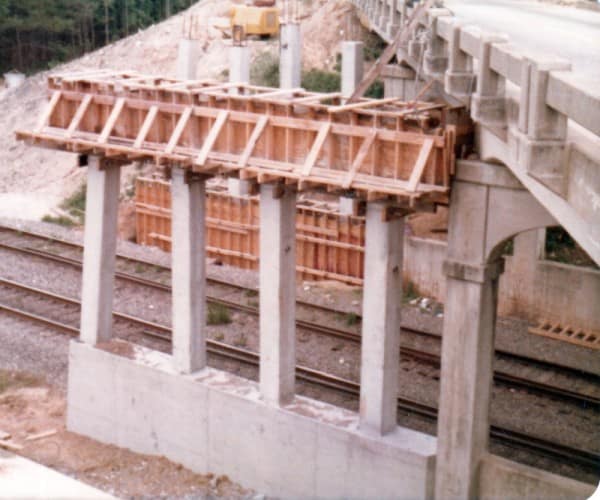

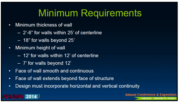

Agree with pikku14 and HotRod10, include crash walls. As a former bridge contractor, we constructed several (see photo)... they are built like battleships. Also below, are typical general requirements for RR crash walls in the USA:

You're going to need to get very familiar with the AREMA, and if it's a UP or BNSF railway, their Guidelines for Railroad Grade Separation Projects.

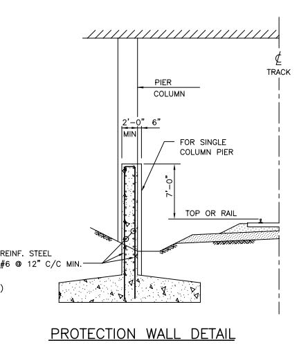

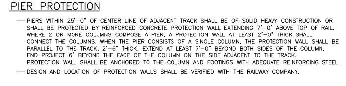

Agreed with the above, a crash-protection wall is definitely required. Reviewing and designing to AREMA is a must. Here are a couple of snippets from CNR (Canadian National Railway) standard details that provide some reference as to what we use up here in Canada. Piers fabricated from concrete filled steel pipes are very common but they must be designed with a large solid wall at their base meeting the crash loading and geometric requirements prescribed in AREMA.
