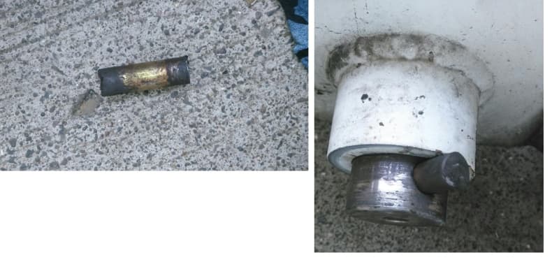

It's a load-lifting mechanism (cylinder is black and the mechanism is yellow) attached to a chassis (grey) and the pivot is orange and you see the locking mechanism that is a 5/8-11 Grade 8 bolt that is running through the "locking ring" welded onto the chassis. The shaft is 2"OD, the locking ring is 3" OD.
At the installation, the torque on the bolt is not controlled (no torque wrench). The bolt is installed with an impact wrench. From my research, the impact could give a torque up to 600lbs.ft. Not that I have reasons to believe it was torque this high but I just don't know how each mechanic "insists" on the impact.. The suggested torque for this fasteners is somewhere between 170-220 (lub-dry).
We've had failures in service that looks like double shear I believe:
So, obviously we will need to specify the torque, and since I suspect over-torquing being a part of the problem, I would tend to keep the torque minimal to allow more room to withstand higher shear but I know that doing this, I'm removing the friction from my side but from what FEA have shown me is that a 200 lbs.ft would not squeeze the shaft enough that the bolt would not see any shear.

I don't understand the pictures relative to the drawing. The drawing shows a hinge pin joining a bunch of pieces together with a cross bolt at the end (to prevent travel of the hinge pin). The pictures look to have a plain slug in lieu of the bolt?
That said, what's being tightened by the impactor ? From the drwgs I assume the cross bolt ? So if the failure is these bolts are being Way over-tightened (nothing being clamped up, just a nut being tightened on shaft) and then there's some lateral load applied in operation, shearing the cross bolt. In this case it is a classical tension-shear interaction, Rt^2+Rs^2 = 1. My suggested solution is to torque the nut with a wrench; if you want to control the torque, then use a torque wrench. Or else add a spring element under the nut, so there is some compression available and some visible sign about how tight the nut is.
Do you understand where the lateral load is coming from ? Is it expected ? Or is it a load not intended by the original design. If so, then you should re-design the joint to account for this lateral load.

The pictures above showed a shaft half-removed (man-removed, and not a sideways load) and remainings of bolts. That looks to have double sheared, right?

the parts (the small pin) in the pic just don't look like a bolt.
part of your problem is that you've got a "gorilla" with an impacter and he's torquing the cr@p out of the nut ... surprised you're not finding the bolt in two pieces (on installation). Find the picture about "who decides the torque on a bolt". As currently designed I think the joint is too rigid for the simple tools (and tool holders?) that you want/need to use. I thinkyou need to introduce some soft element (copper washer ?) that'll collapse under load.

You have a problem that is different that what you suspect. The keeper's, i.e., the bolt, purpose is to keep the pin from working out when the machine is in operation. The various components,i.e., the hydraulic cylinder should be rotating freely on the pin. If there is insufficient or no lubrication on the pin, the hydraulic cylinder is forcing the pin to rotate and shear both ends of the keeper (as seen in the photograph). I suspect the pin and the hydraulic cylinder are galled and roughened. Now, no amount of lubrication is going to help. The clevis end of the hydraulic cylinder needs to be repaired and a new pin with grease fittings installed. The pins do have a grease fitting right?

"so far, the FEAs give me around ~11 000 lbs shearing force at each interface." but this shear is carried by the hinge pin; this is not the shear that is causing the failure (which looks to be axial along the pin, yes?) or is this force acting along the hinge pin axis ?
rb1957: what do you mean the "joint is too rigid"? ... it looks to me has though you are putting a bolt into a hole in a solid shaft (as a cross bolt) then torquing the nut against the shaft. There is nothing to deflect under the tension from the torque, not flexibility in the joint, you're tightening the head of the bolt with the nut on the opposite side of the solid shaft. Without careful control of the torque it is easy to overload the bolt, it is difficult to know the torque you're applying.
