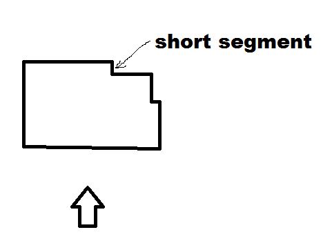

We have a project and have come upon a problem - wondering if others have an approach to deal with it.
1. Single story building - generally rectangular in plan with one of the long walls having a jog or offset. There is also a small offset in the short wall near the long wall offset.
2. The building is supported by perimeter load-bearing precast wall panels all around which serve as shear walls as well.
3. The roof is steel joist with metal decking.
4. Wind case perpendicular to long walls.
5. Because of the jog in the long wall, there is a short precast wall segment about 3/4 of the way down the wall.
6. This wall segment acts as an intermediate, short shear wall and with classic tributary wind design attracts a LOT of load.
7. If we model a semi-rigid diaphragm, the shear wall still attracts a lot of load.
8. With the offset in the short wall, the "end wall" of the long rectangular diaphragm has two separate shear walls - an inner wall and an outer wall.
9. The inner wall attracts a lot of the load and the outer wall is actually attracting a small amount of load in the opposite direction due to bending/deflection in the diaphragm.
10. We have included spring supports to model the shear wall stiffnesses as well - this doesn't help all that much.
Is there any approach to analysis where you can minimize the load in these short segment offset shear walls? We thought of having a slip connection between wall and diaphragm to release the shear from it but that is very complicated and of questionable efficacy.

Can you assume a flexible diaphragm that spans the full length of the building and ignore any resistance offered by the short segment? Of course it would have to be detailed accordingly.
Edit....missed your last sentence, guess you already considered that. Surprised item 10 did not have much effect. If its stiffness is (presumably) less than the longer walls, I would not expect it to attract that much load.
Are your joists running parallel with these "short shear walls" or perpendicular to them?
If parallel, are there girders framing into the "middle shear wall", tagged in your sketch? I assume there would be girders framing into the "inside shear wall", but how many?
I`m very interested in the question and think that there will be a different answer depending on the configuration of the gravity system.
Typically my buildings use non load bearing precast. When you use load bearing, how do you deal with chord forces? Is there a panel-panel connection at EVERY panel joint to transfer this diaphragm T/C?
Would it be possible to detail a diaphragm chord running EW at the N end of "outside shear wall" and artificially limit your diapgrahm depth to the length of that wall? This will increase your diaphragm forces, but if your loads are small that may not be a big problem.

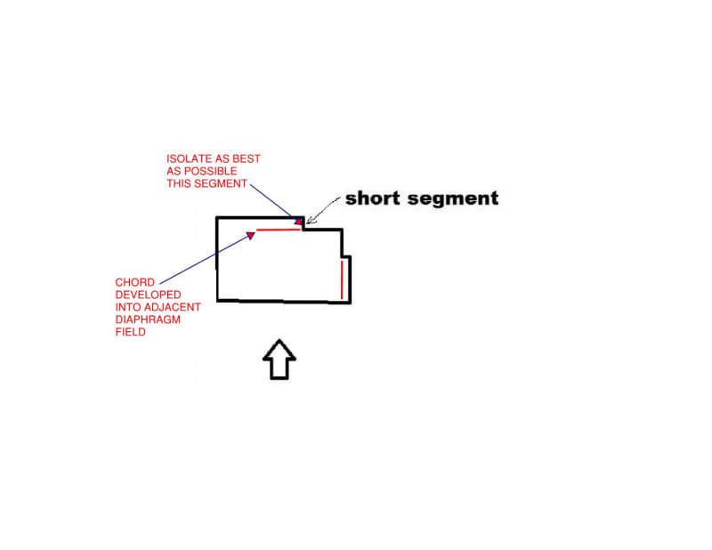

The things that come to my mind:
1. Do the "slip connection" (at the header/top plate). You might could justify the release based on a max gravity load attributable to that location (using a ultra-conservative coefficient of friction and being sure there is no physical mechanism that could make it happen anyway).
2. Add another "chord" to the diaphragm (or beef up the ones you've got) to stiffen it up.
3. Perhaps add another shear wall on the interior. As far as the users are concerned, it would be a partition.....but you would know better.
What about the foundation level for that short segment? If that is detailed to allow rotation of the wall then it shouldn't attract much shear.
Does that wall have to be concrete or could you frame it from something else more flexible?
Could you make it a spandrel panel where it doesn't extend to the foundation and is just along for the ride? Nice spot for some windows at grade?
Since you mentioned wind loads, I assume you don't need to accommodate the large deflections associated with seismic design.
If this is true, I would treat the diaphragm like a beam, uncoped on the left end, and coped on the right end. The reaction at the right end will generate a moment on the diaphragm which must be "developed" into the diaphragm, using roof framing members. The short wall segment can be ignored, if you can justify the midspan diaphragm deflection at the short wall segment.
DaveAtkins
We have run into similar cases before and attempted to isolate the short segment with horizontal slots and detailed the adjacent walls to isolate the problem segment as much as possible. I think we also checked how much deflection there would be if the short segment had zero stiffness and judged how much damage there might be to it and the attaching deck if the isolation didn't work as intended.
Pretend that the short bits are non-existent for your analysis and come what may. Seriously, that's my personal recommendation. We make messy buildings, not meticulously crafted pianos. There's a limit to our "knowing". Chords & drag struts... you bet.

Since the end walls are significantly stiffer, I am surprised that any load is going to the short intermediate wall. Have you tried modeling a horizontal truss in the roof plane to force the load to the exterior wall?
If you do not provide a drag link in the roof diaphragm, the load will not be collected to the wall, regardless of any wall connection.
Put a window in the short wall segment to make it weaker...

Thanks for all the replies.
Some other facts:
a. The roof joists are clear span across the entire width.
b. We have modeled the diaphragm as a series of "horizontal beams" along the edges, so to speak, with a stiffness both in flexure and shear that attempts to mimic the deflection behavior of a metal deck diaphragm under the proposed loads.
c. We have monkeyed around a bit with the wall stiffness, proportional to the individual wall lengths and also set to assume a range of shear wall deflections normally expected for rigid concrete shear walls on shallow spread footings....so a parametric analysis solution where we vary the diaphragm support stiffnesses (the shear walls) to again mimic expected lateral deflections in those systems across a range of values.
d. The idea of separating the small shear wall from the diaphragm occurred to us but seems impractical as the wall is comprised of two panels and we must connect back to the diaphragm perpendicular to the building at least.
e. For some other comments/questions:
There is small seismic.
Joists are spanning the short direction (up and down on my sketch), no girders.
Joists do not align, currently, with the short walls so right now no particular collector.
We might add one but that would not solve the problem of high shear attracted to the short wall.
Slip connection: diaphragm to wall is tough to detail right and questionable in true behavior I think.
Walls are all interconnected so if the overall diaphragm deflects, the small shear wall will naturally want to deflect with it.
Kootk's suggestion along with haynewp's thoughts might be the only true answer...i.e. detailing around presumed pseudo deformation/damage near the short wall but ensuring adequate overall safety.
Just thought I'd poll others here to see if we are not seeing a forest for the trees or something.

For what's its worth, we use KootK's approach with our precast walls where necessary. All diaphragm connections to said walls are slip and our diaphragm is assumed semi-rigid.
