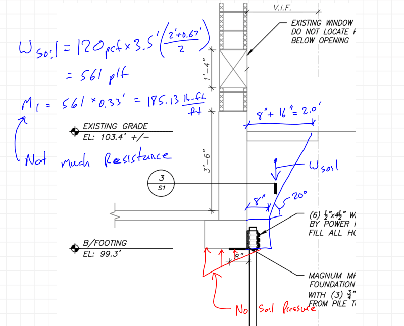

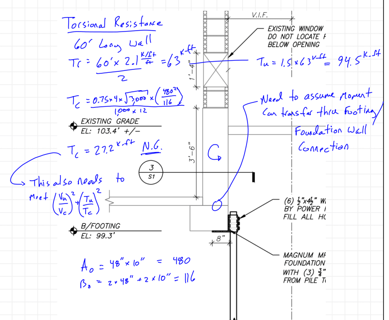

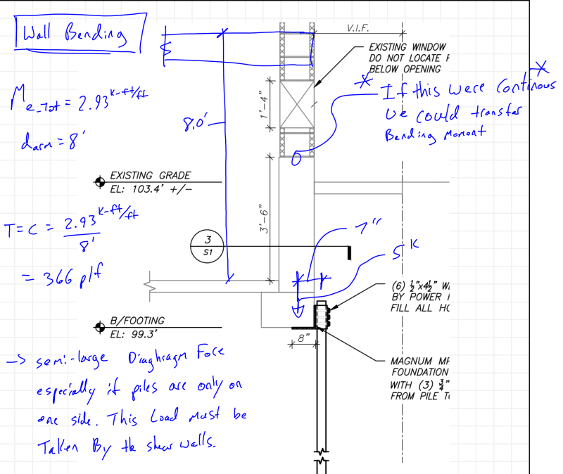

So this would suggest that the foundation wall handles the eccentric moment. There are a few ways it could do this:
1. Torsion - for a long stretch of wall, say 60', this Torsion would be rather large.
2. Bending and a T/C couple between the slab on grade and the first floor. This would not work in this case as there could be a hinge at the top of the foundation wall.
3. Dead weight of the soils on the back side of the footing.

I beleive it has to leave the kern. We can no longer rely on soil pressure below the footing as it is now being supported by a deep foundation. The only reaction point is at the edge of the foundation wall + the pipe dimeter. So there are two general systems to restrain this rotation. The first is the foundation wall (described above). The second is the bracket and pile. The more I think about it this becomes a stiffness problem, but I'm willing to ignore that for now.

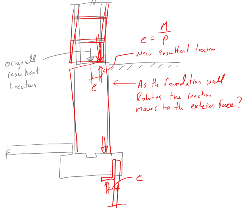

You missed something about systems that resist rotation. How's about that floor load? As the wall top end tends to rotate out from under that load, the center of pressure moves to the inside edge. Also the earth pressure likely redivides or even becomes zero.
I'm trying to understand this a bit better. I can see this being a good argument for why the eccentricity should only be taken from the edge of the concrete, but I can't quite seem to draw this free body force diagram. Here is an attempt:
EIT
